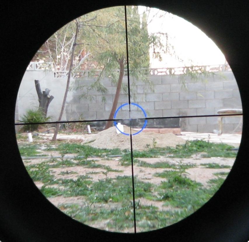

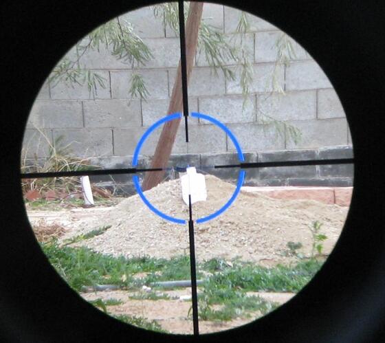

1X

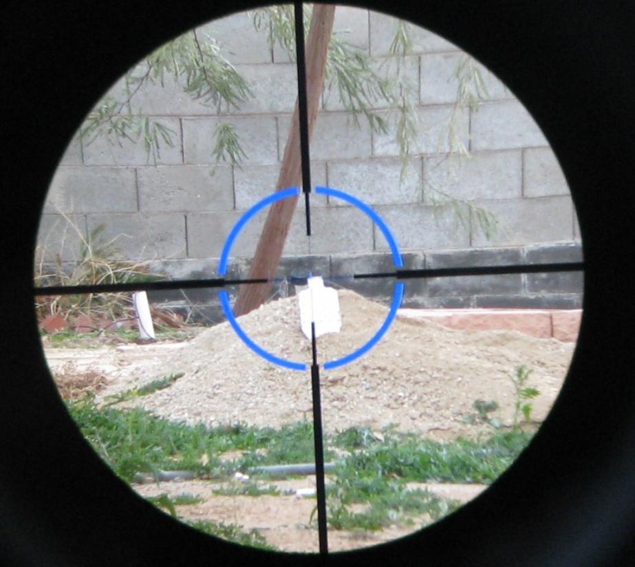

4X

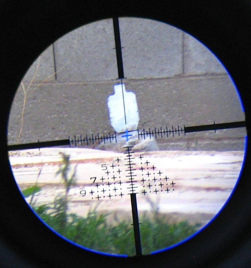

8X
Yep there you have it folks conclusive proof, a metric poopload & tons of distortions & curvature noted in these pics.
It was written on the internet so it must be true…
You can see rather extreme pin cushion distortion in the 1x and 4x pictures by looking at the cinder block wall. Or the wall is sagging in the middle from a questionable masonry job that just happens to line up with the target. :slight_smile:
Not that other scopes don’t also suffer from the same exact thing, of course. Even the S&B short dot has a bit.

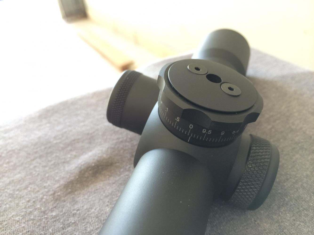

Just got mine (SR-8C) and yes, you can order it with the mini EREK knob
does that amount of pincushion matter?
That’s entirely up to you. Does it bother me? Not really. But some people are pretty damn picky, especially when it comes to a $2000 piece of glass.
I guess I should have asked more specifically… how does pin cushion affect performance? why does it matter? is this scope good enough with that type of artifact inherent in design?
Pin cushion and barrel distortion don’t affect the optical performance unless they bother the user to the point of distraction. At some point an extreme amount of distortion may cause unnecessary eye fatigue as your eyes and brain try to cope with the unrealistic view through the scope.
One thing to keep in mind is that camera lenses suffer from the same problem, so the distortion in the pictures above could be caused by his particular camera/lens, and not the scope!
Voodoo’s opinion and experience holds a lot of weight, so if he’s happy with it I don’t think there’s anything to worry about.
I think I know your posts well enough to assume this is sarcasm, but just making absolutely sure since I do see some distortion and curvature… you’re not concerned at all about the SR8c, right?
I think this thread is well past the pale of ridiculous & teetering on risible & farcical, seriously.
Extreme? That seems rather minimal.
In terms of optical properties of the scope, it is pretty bad when it’s noticeable halfway between the reticle center and the edge of the view circle. Even a $250 kit lens off a cheap SLR generally won’t display that kind of distortion except at the very edge. Obviously a rifle scope is not a camera lens, and the designer is forced to deal with size, weight, and a variable distance to the eyeball of the user in terms of exit pupil and eye relief. This is why I basically said previously that if it doesn’t bother you, there’s no reason not to use the scope.
Ultimately, it is an optical defect, which, considering the price of the SR8, may be an indication that more money was put into the illumination as compared to the optics.

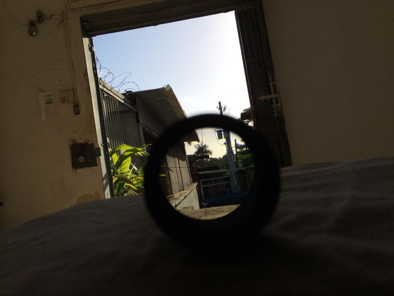

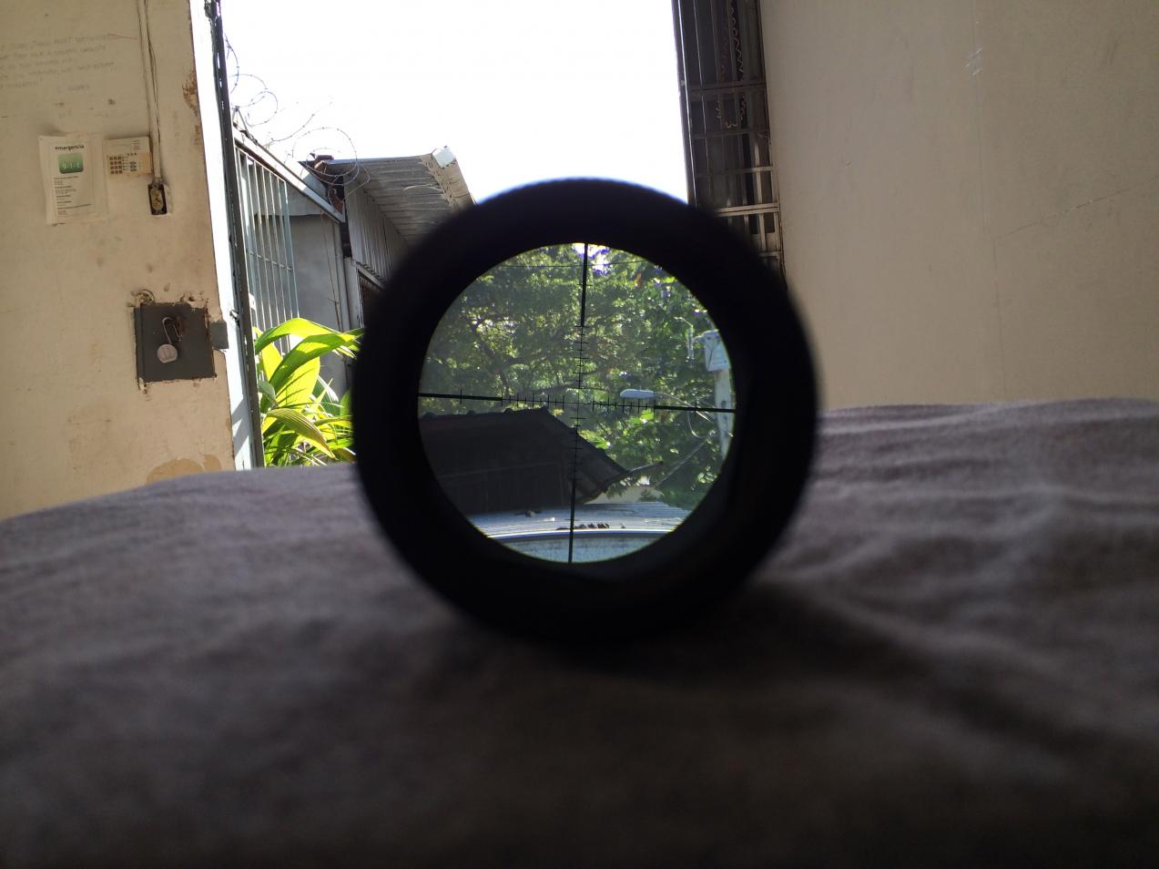

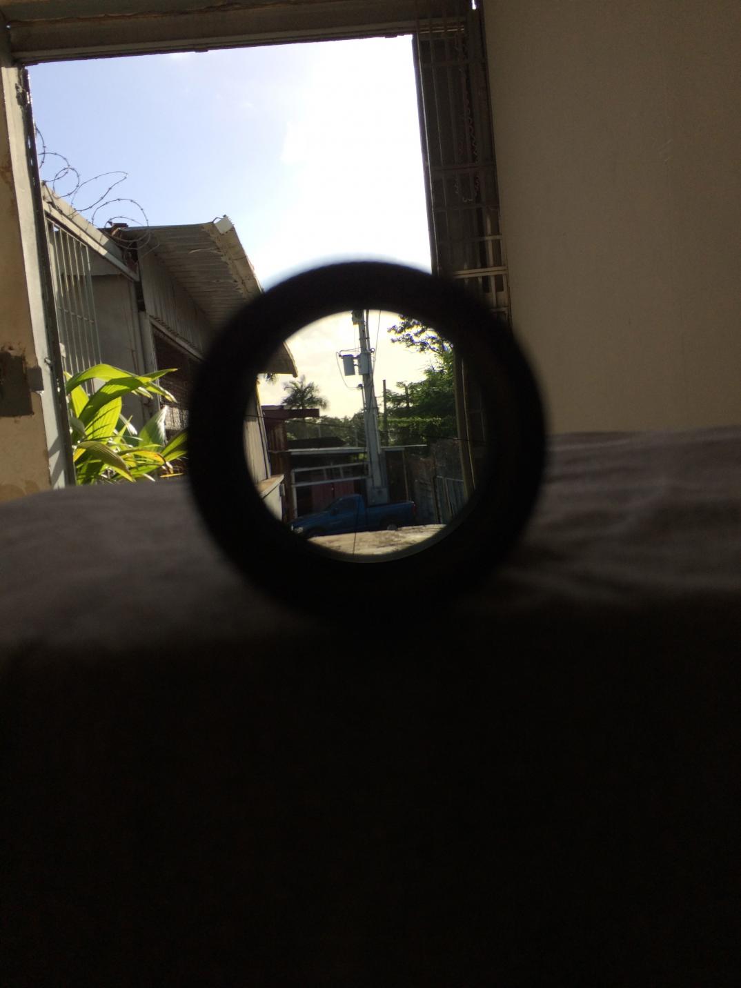

Mine unfortunately, does seem to have a high amount of distortion in the glass though. Maybe I’m spoiled by my Mark 6, but I like it when the lines I’m looking at are straight! The pic below was also taken at 1.5x mag. For some reason when I have the mag set to 1x the image in the scope looks smaller and further away than 1x with a high amount of fish-eye. Changing the mag to 1.5x makes it look neutral.
Interesting mine doesn’t do that.
I’d send it back to USO for calibration check etc. Should be free, it’s just the hassle.
keep us posted.
I have an SR-8c on the way as well since Opticsplanet’s coupon code the other week brought it in to less than $200 more than the SR-8s. It’ll be nice to compare it to see if this is just how the glass is, or if there’s something really wrong with this SR-8s I got. I’ll post an update when I get it and can compare. I really hope it’s this particular scope though, since my cheap, Chinese Mark 4 clone (got it as a gift) has less distortion than this!
