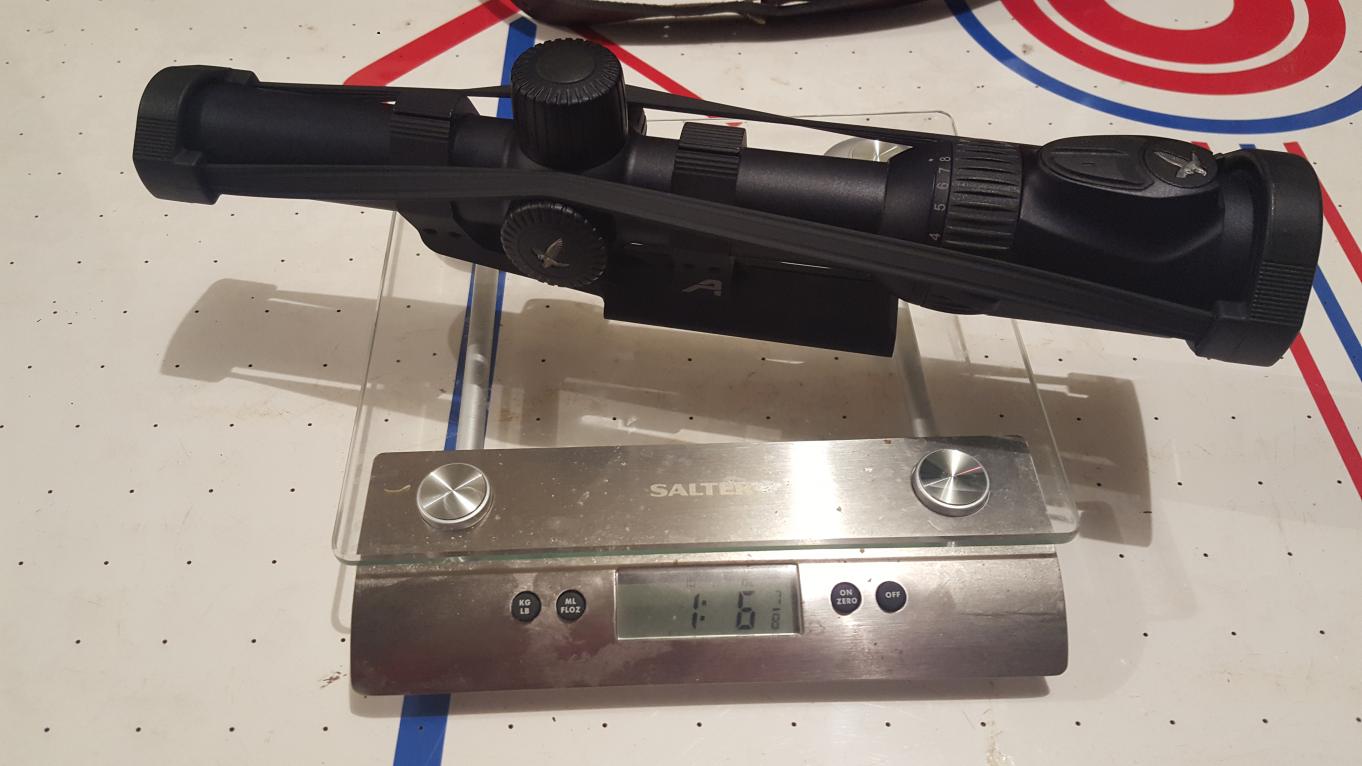

swarovski z8i + aero mount just shy of 23 ounces with lens caps

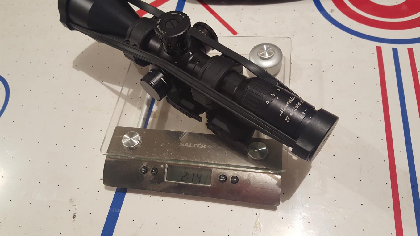

Hensoldt 4-16 FFP + bobro mount 46.5 ounces

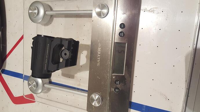

Older gen Bobro QD 30mm Aimpiont mount. This is the lower 1/3rd mount.
The current gen on there website lists 4.8oz, this one kept bouncing between 4.9 and 5.0 on my scale.
