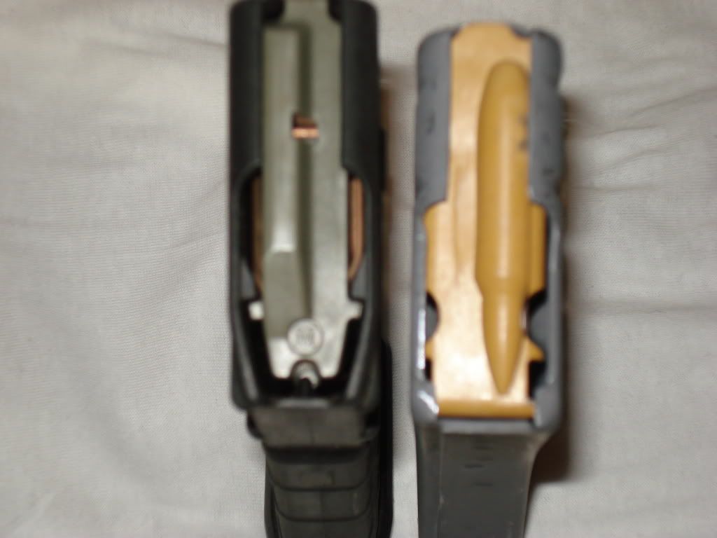

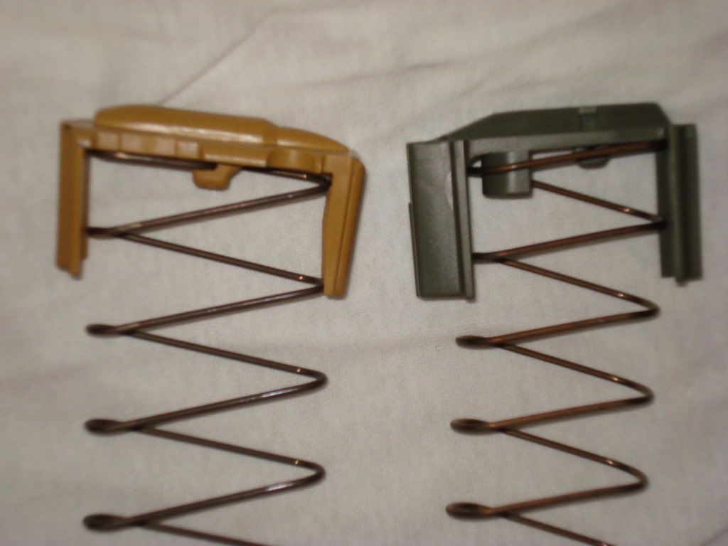

These are new to me anyway. The follower is a mustard/tan color. It’s design is more anti-tilt than the green follower and is almost on par with magpul, but seems to tilt more in the rear if that matters. The follower fills the mag body better than a magpul follower, and it makes me wonder if sand and dirt will be more problematic than with a magpul. The most notable difference to me is that the cartridge placement portion (the part that looks like a fake cartridge) is on the left side, opposite any other mag I have seen. This may be problematic to those who rely on round recognition for loading or ammo count purposes, being easy to mix up, confuse, or forget. I probably won’t be able to test these mags, at least for awhile, other than a couple mags worth of ammo anyway. I wonder if they will seat fully loaded better than others.
These may not appeal to many who have caught the pmag wave. But there are a few no doubt who run pmags and GI mags, and probably still some who run only GI mags. I have yet to see any of these available at gun stores. Made by center ind., with elkay plastics name on the packaging (maybe the makers of the follower?).

I’m trying to find information on these new followers. Any reason as to why they (whoever they is) decided to have the odd rounds load from the right side of the mag? I imagine this will impact some of us that have built up muscle/mind memory that run followers other than these while doing press checks.
There was a metric buttload of them for sale @ the Fredericksburg, VA goon show this past weekend.
NIH, as mentioned, is strong. It’s a metal mag with an anti-tilt follower; nothing of note about it, except for the hump, which they shifted to the other side (like the ARC mag) to avoid a patent pee-pee slap from Magpul, I imagine. Still should load to 28, along with the rest of the metal-mag boilerplate.
They work okay. IAR’s getting fielded with these, so they’re gonna get common pretty quick.
I have not found any reason for switching the side the first round goes on. Best guess is that it’s another arbitrary change, like the stupid yellow-brass color choice, intended to distinguish these from the superior, preexisting COTS alternative. But maybe there is some better reason, somewhere. I just haven’t seen it.
