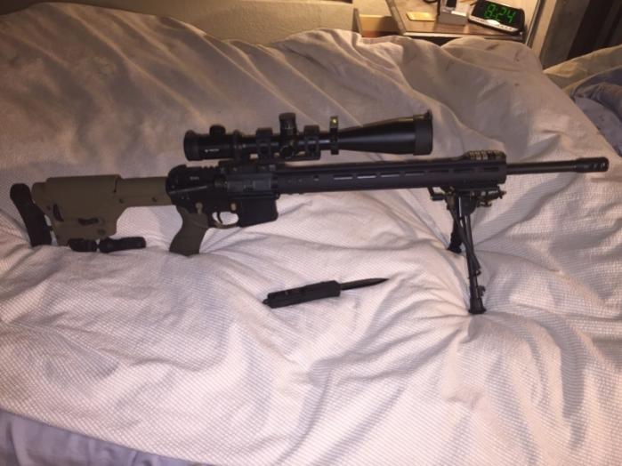

My New 6.5 Grendel SASS
Here she is. Been to the range once, great shooter.
Build Highlights:
  • PRS Stock w/mono-pod
  • SSA-E Trigger
  • BAD ASS Safety
  • Raptor Charging Handle
  • ALG 15’ HG
  • Black Hole 20" Stainless .264 LBC barrel
  • Harris bipod
  • Vortex Viper PST 6-24 Scope in ADM mount
  • Precision Firearms LMD brake
Lookin’ good! Is that a LaRue pistol grip?
wow good eyes!.. I can hardly see the grip in the low res photos. Yes it is. The LaRue A-Peg. I like it, have tried Ergo Grip and Magpul MOE+ but the LaRue is my favorite. Its very sturdy, rather wide compared to others and formed well to fit the hand. Very ergonomic. If your looking for a new grip I would pick one up.

The bolt is a 7.62/39 from SAA, headspaced to my barrel (by SAA). I got the entire BCG for $88, thought it was a great deal so why not. So far so good
SAA? How do you like the BHW barrel?
Fit and finish is great. If the barrel performs near what I expected it to its great value, I got the barrel, upper and BCG for about $400 shipped. have not yet shot to test the accuracy capacity. Only have shot the gun/barrel once, 15 rounds to sight it in with wolf gold. I have a few boxes of A-Max 123gr for my next range trip. Will post results here .

Here is the barrel description and specs:
Black Hole Weaponry Barrels employ the use of 416R, match grade stainless steel. BHW Barrels specialize in Polygonal rifling; The shape of the lands and grooves are based on a circle, so there are no sharp corners or edges for the bullet to conform into. This means there is a tight seal and thus less bullet deformation. This rifling form is unique in its ability to allow the bullet to be centered and fully supported by the barrel’s bore.This arc shaped rifling has long been held in very high regard for its accuracy, increased velocity, reduced gas cutting and ease of cleaning.
Caliber: 6.5 Grendel Type 1
Barrel Length: 20" H-Bar (Standard Profile)
Gas System: Rifle-Length
Barrel Material: 416 Stainless Steel
Barrel Finish: Matte Black
Rifling: 1:9 Polygonal 3 groove
M4 feed ramp is included
Under handguard: 0.88 inches
In front of gas block: 0.73 inches
Threading (TPI): 5/8x24"
http://www.surplusammo.com/black-hole-weaponry-ar-15-20-rifle-length-stainless-steel-6-5-grendel-1-9-poly-barrel/?page_context=category&faceted_search=0

Got to the range today. Most of the shots I took where getting the new Burris XTRII 4-20 dialed in. Once I was done zeroing. I shot some pretty good groups. On one target I shot a 1.5 moa, 1 1/8 moa, 7/8 moa, and a 3/4 moa group. I was using A-Max 123 grain ammo, 3 shot groups at 100 yards. I consider myself to be a novice shooter so I am sure that in more capable hands 1/2 moa is easily achievable.
