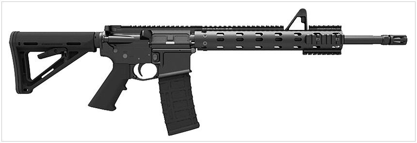

Thanks for the quick reply, but I should have clarified that I’m specifically looking for a ‘slick’ tubular design, like the DDM4 V7/MFR.

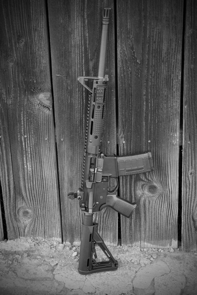

The Mossie Midnight Mount works well with a middy gas system and FSB. The picture in the link below is a middy with FSB:
http://battlecomp.com/store/index.php?main_page=product_info&cPath=3&products_id=48

I quickly threw this together in Photoshop to illustrate what I’m thinking of, although of course it’s just a concept image:

If somebody produced that, it would sell like hotcakes. It would have to be a two piece design and I don’t know how “slick” it would end up being once you design in places for the two halves to bolt together. Clearing the bayonet lug on the FSB might be problematic and the very reason Troy puts that drop down area with a rail on their tubes.

I’ve seen photos of a VTAC hand guard with a carbine cutout and full top rail. I don’t know if it’s a production item or someone had it cut.

It wouldn’t have to be a two piece design, but would be a more of a PITA to install if was one piece. Obvously, one would need to slide the one piece HG on with the FSB/gas tube simultaneously and the tube would need to have holes to access the FSB pins. Most likely the lug and the swivel ears would have to go if a slim tube is desired.
