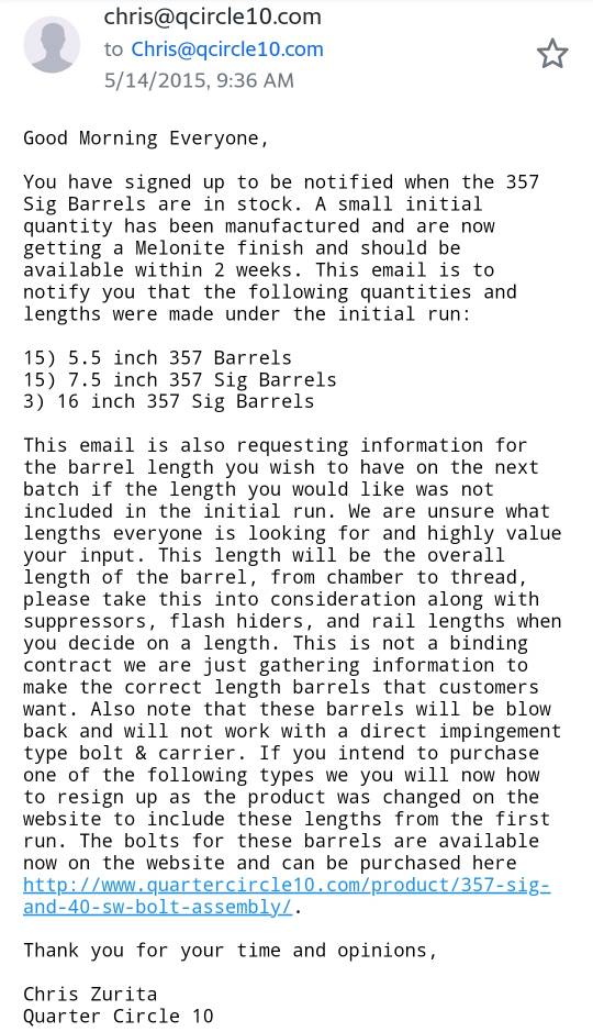

I probably have 200rds down range and it runs flawlessly so far. No sign of damage to the rifle or internsls thus far. I was able to dig up an email regarding the purchase- attached. A subsequent Sept 2017 email inquiring if they (QC10) were going to produce additional 357 SIG AR barrels received this reply:
“Probably not in blowback configuration. It’s just too easy to make it unsafe. We’re going to be looking at some other options, so stay tuned.”
