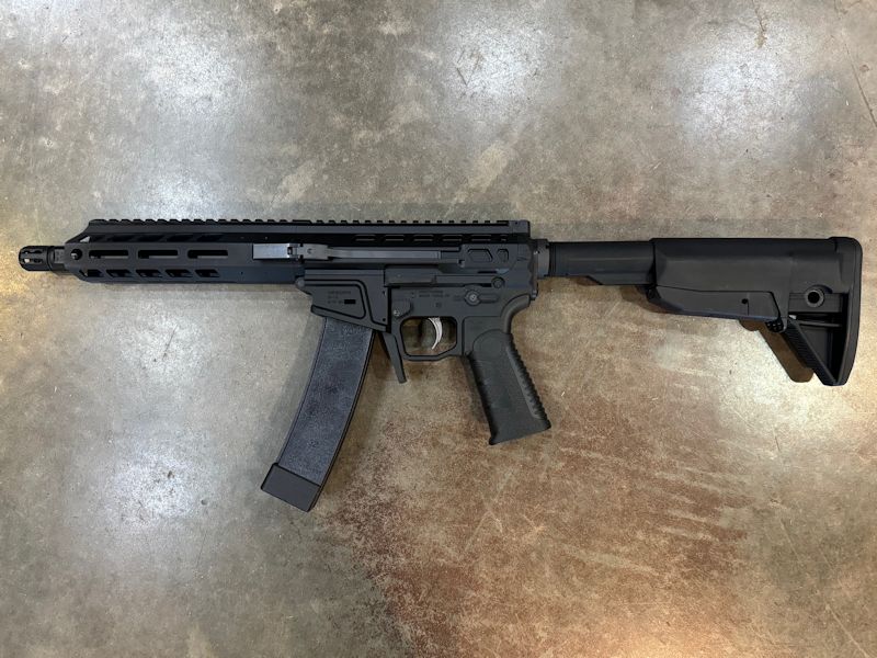

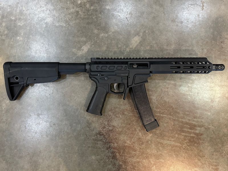

Surfing the internet I found an interesting 9mm AR15 variant. This particular one takes CZ Scorpion magazines. I don’t have a Scorpion, but I do have a 9mm AK pistol that takes Scorpion magazines. I read up and they seem to have good reviews with a good price. So, I decided to get their factory SBR version. It arrived at my dealer today and appears to be very well made. The fit and finish are really nice. I hope it performs as well. They also make a pistol version and a rifle version. The rifle version can be had for only $550. Here are a couple of pictures.

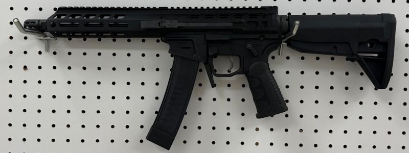

It’s out of NFA jail. Range report to follow.
