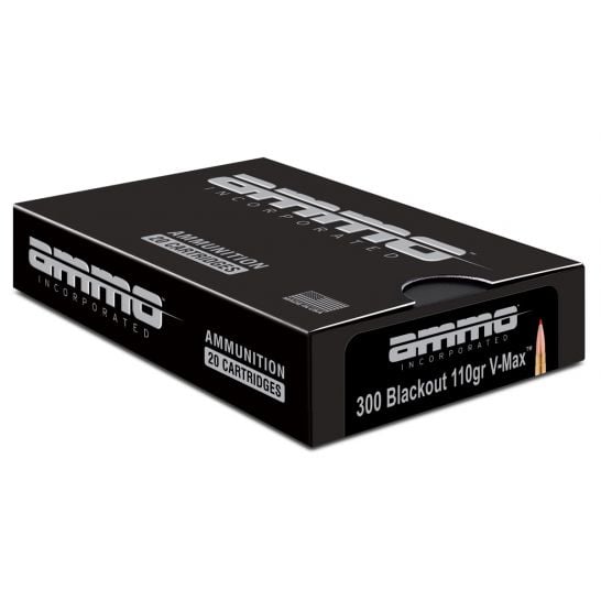

I’ve been tempted to pick up some of this, but I’m sitting on almost 2 cases of the Barnes 110 grain magic slayer ammo. Still, I’m tempted.
https://palmettostatearmory.com/ammo-inc-signature-110-gr-v-max-300-blackout-ammunition-20-rounds-300b110vmx-a20.html?utm_medium=email&utm_source=daily_deals&utm_campaign=20230103&utm_term=morning

All of these 110gr loads are supersonic, not subsonic like the guy is asking for. And they take a fair amount of velocity to expand - which drops off quickly in most short barreled 300BLK rifles which makes your lethal range usually pretty short. Look up the minimum reliable expanstion velocity for that bullet, and use a ballistic calculator to plot the velocity of your round at different distances. Not that a hole poked in someone won’t still hurt, but it’s a far cry from a typical expanding rifle round wound.
