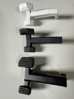

Solved it! Took out my Dremel and just kidding. The thought did cross my mind, but I quickly squashed it. I did wonder about taking the offending interfering part of the bolt catch and bending it to make it clear. Not sure if it is steel or aluminum.
Swapped the lower stuff back to my Noveske lower.
This is my first ambi lower. I’ve played with the Norton and BAd levers and looked at the LMTs, but no one had them locally, and ordering them was a pain. I really only bought this one because we are staring down an AWB here in CO, maybe. That and like I said, I’m throwing everything at this build- like down to the JP operating system. So those two reasons combined I was like ‘why not’. Already had some other lowers and guns on the BGC.

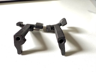

I did get the offending part off and I’m going to mock up a ‘bent’ part and try 3D printing it. I have some CF nylon, but this would be the perfect use of the BASF ‘metal’ filament. THe CF nylon is pretty gangster and the part isn’t that stressed- and this is my gamer gun.

Took me more than a few tries to get it, but I think I have it now.
Original on left and bottom, mine to the right and above. White was the initial work in PETG, the black is PA carbon filled. Pretty strong. Clears under the VLTOR and is a bit ‘proud’ to the standard.
