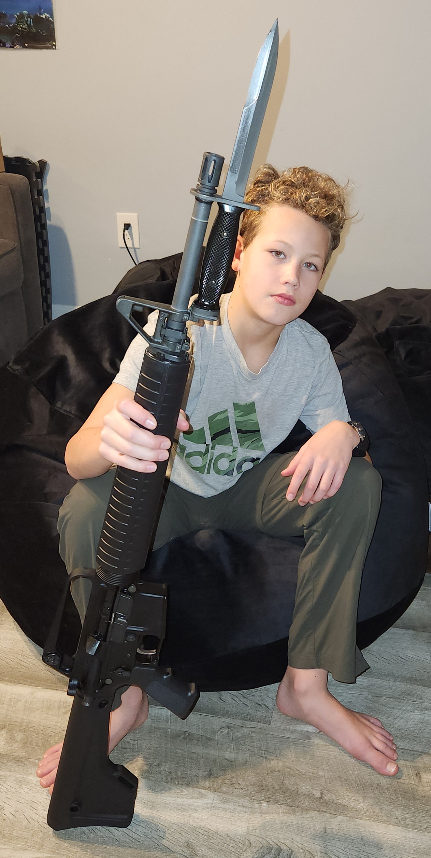

Colt barrel
Colt FSB
Colt gas tube
Colt delta ring assembly
Colt charging handle
Colt A2 grip
Colt handguard cap
Colt flash hider
Colt handguard set
Rock river arms front swivel mount
Brownells C7 upper
Brownells A1 sight
Palmetto state armory dust cover
Palmetto state armory forward assist
Palmetto state armory trigger guard
Brownells buffer tube
Sprinco buffer spring
SOLGW rifle buffer
Aero precision lower, X15,
Sionics LPK and enhanced trigger
Magpul moe stock
Toolcraft phosphated BCG
I pinned the front sight base for him. My 12 year old assembled it. It required 2 clicks of windage for a true 273 yard (250m zero)
Good work kid!!
Well, that is good information to know. Quite surprising I might add also, considering Colt should be using jigs set up for barrel drilling etc…
It really was not that hard. Small round file from my die makers set, taper reamer, and lots of bore sighting and being patient.
That’s impressive. Did you start with an FSB that has some sort of pin holes to begin with?
The barrel was already drilled for a FSB that I did not have. I bought a used complete FSB. The holes were very close. By eye ball, I knew this could work. By measure, 0.020 inches of barrel to remove before the taper reamer could be used.
