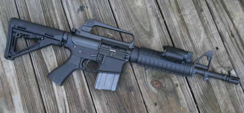

I used a peice of copper tubing on my wife’s SBR to make up the difference I can’t recall it’s diameter. It’s a large pin Colt SP1 upper on a newer small pin RRA lower. Just buy a couple inches of different sizes at the hardware store that are close in diameter to the diameter of the upper receiver.
