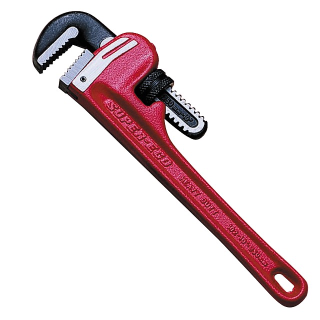

Pipe wrench rarely used but when the bbl nut is damn near welded on, I cut the delta ring, snap ring and weld spring (with a large set of bolt cutters above) and remove and use the pipe wrench to remove the bbl nut (I have about 15 spare bbl nuts)
