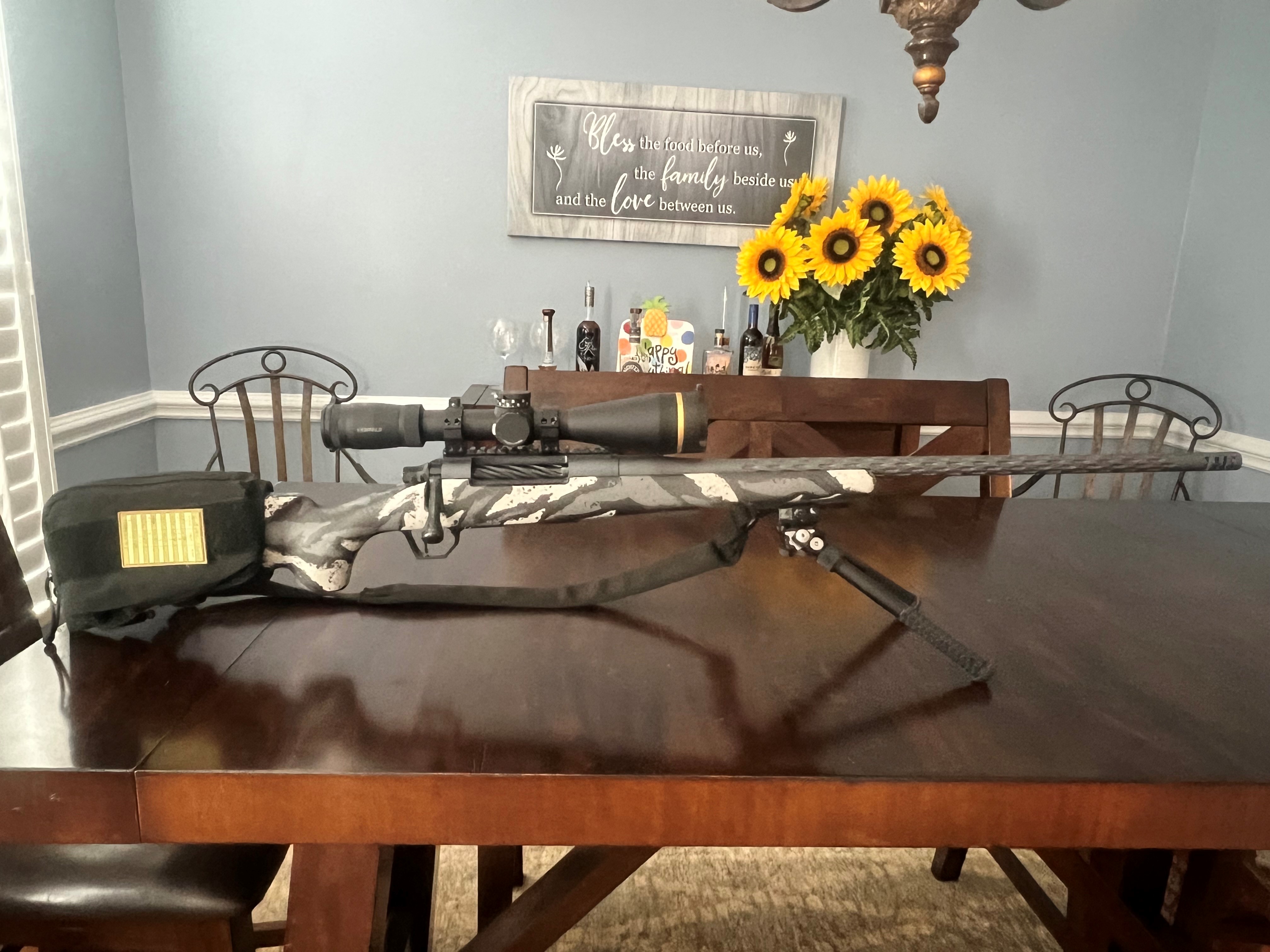

Here’s the new 7mmPRC. Actually it started out as a 6.5PRC that I had re-barreled to 7PRC. At this point I have a Leupold VX6HD 3-18 on it. However, I have a NF NX8 4-32 and I may swap it over to this rifle.
