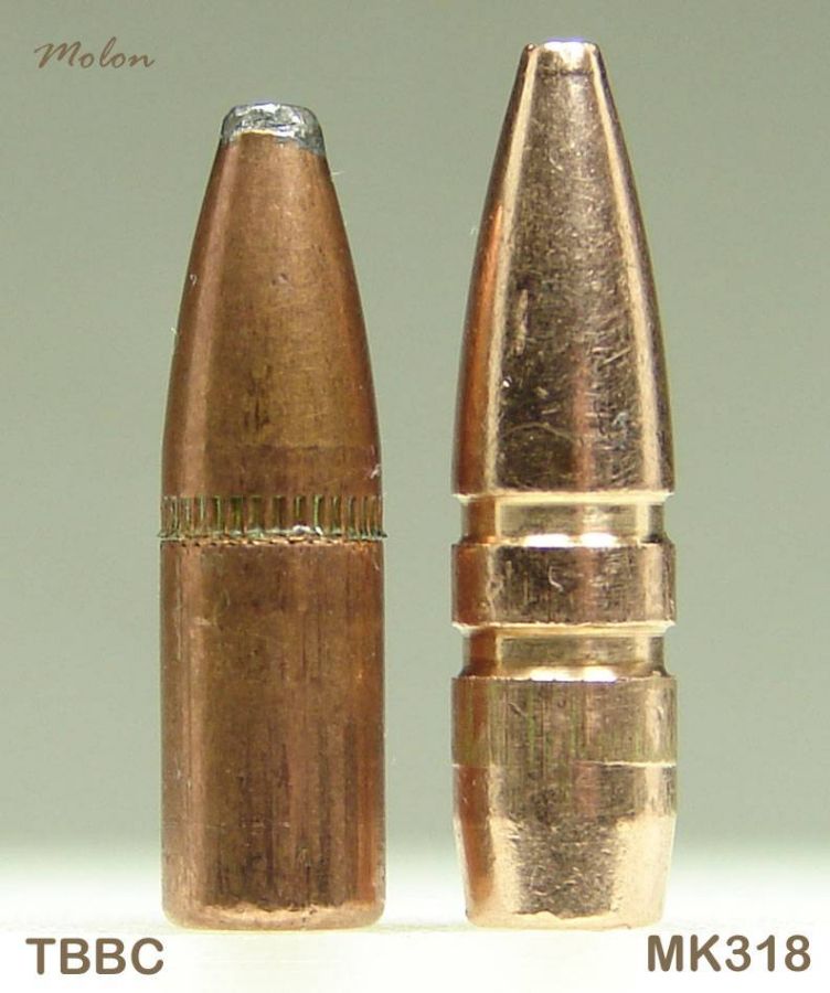

The ND stuff does NOT look like a Fusion/Gold Dot bullet, looks more like a TBBC which would make sense since TBBC is only sold under Federal exclusively while Fusion/Gold Dot rolls out of the Speer line and is rebranded to Federal.
Not sure how a unbonded TBBC would work since the bonding process of the TBBC vs Fusion/Gold Dot is baked vs plated but from what Ive seen from cross sections an unbonded TBBC looks very similar to a Mk318 SOST. Not 100% sure so Im going to ask the interwebs for their opinion:
https://www.m4carbine.net/showthread.php?240416-Federal-ND55664-overruns
Unbonded TBBC is a reasonable description of Mk318, I think.

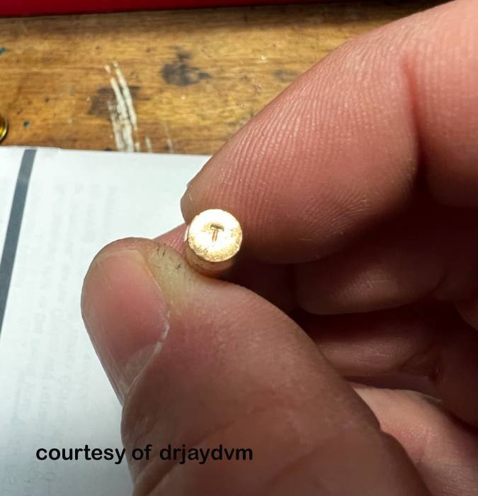

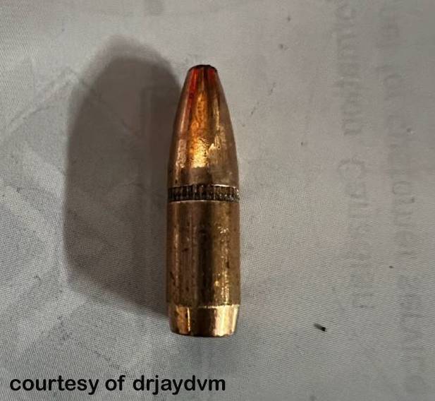

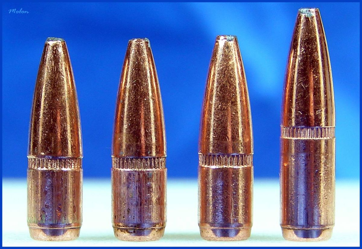

No it doesn’t. Neither the Federal Fusion nor Federal Fusion MSR weigh 64 grains. They’re both 62 grain bullets.
Did you look at the bottom of the bullet you pulled? It’s a 64 grain Trophy Bonded Bear Claw.

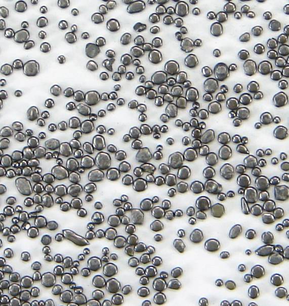

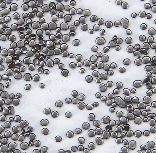

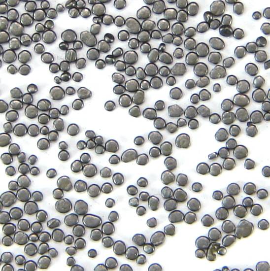

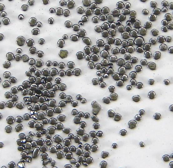

You think that you can determine that the powders are the same just by looking at them? Correctly identify the four different powders shown below.
Powder 1
Powder 2
Powder 3
Powder 4
Because they do.
Left to right: 1.) 62 grain Fusion, 2.) 62 grain Gold Dot, 3.) 64 grain Gold Dot, 4.) 75 grain Gold Dot.

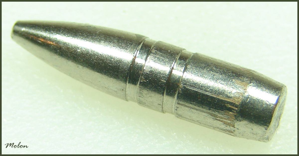

There’s no such thing as an “unbonded” Trophy Bonded Bear Claw in caliber .224" sold on the commercial market.

Some of your above bullet pictures are credited to a veterinarian…… where might I find whatever context that would have originally been associated?
