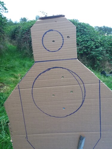

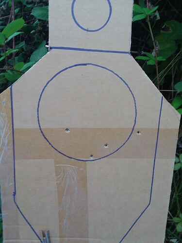

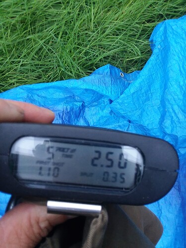

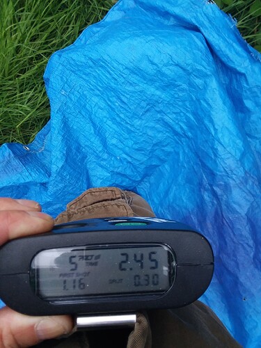

Shot it again a couple times today, this time from AIWB. And holy shit is it faster, as expected.
First round, cold. 2.50.
Happy with the hits too.
