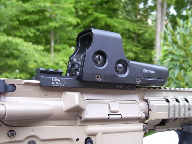

Eotech 512 in Larue mount

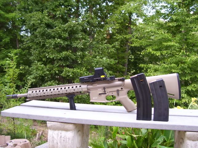

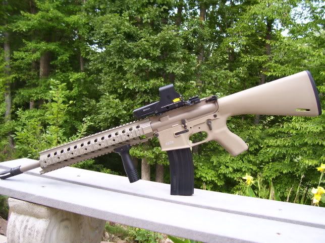

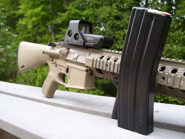

Here are some other misc pictures
