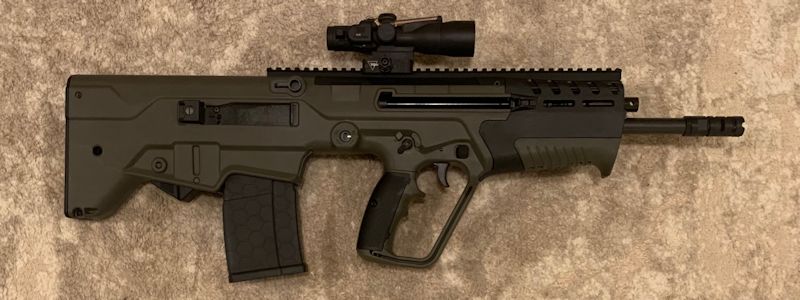

A Tavor 7 followed me home. I found a good deal on a 3x30 TA33 ACOG with 308Win reticle, so I picked it up as it seems appropriate for a 308Win bullpup.
