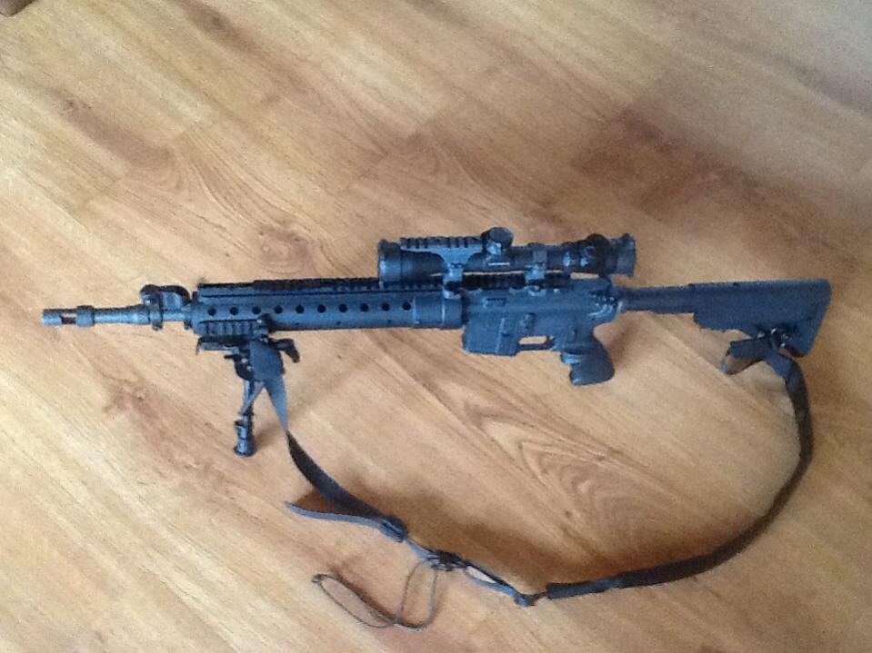

Plan on ordering a Sprinco Green spring for my MK 12 with A5 extension. anyone use the Green Spring?
And the 5 Coil extractor spring…anyone use this?
I have a green spring in an A5. No issues, so I don’t really have much else to say. :slight_smile:
I have 3 springco greens and 2 colt rifle springs for A5 systems. Either works just fine and would in your build.
Can you tell a difference between the stock spring and the green spring?
I have a Sprinco green w/ an A5H4 in a M&P15 carbine… never had a single problem & runs 100%. But these rifles are known to be overgassed.

Thanks I decided on the Green Spring in my MK 12 with A2 stock
