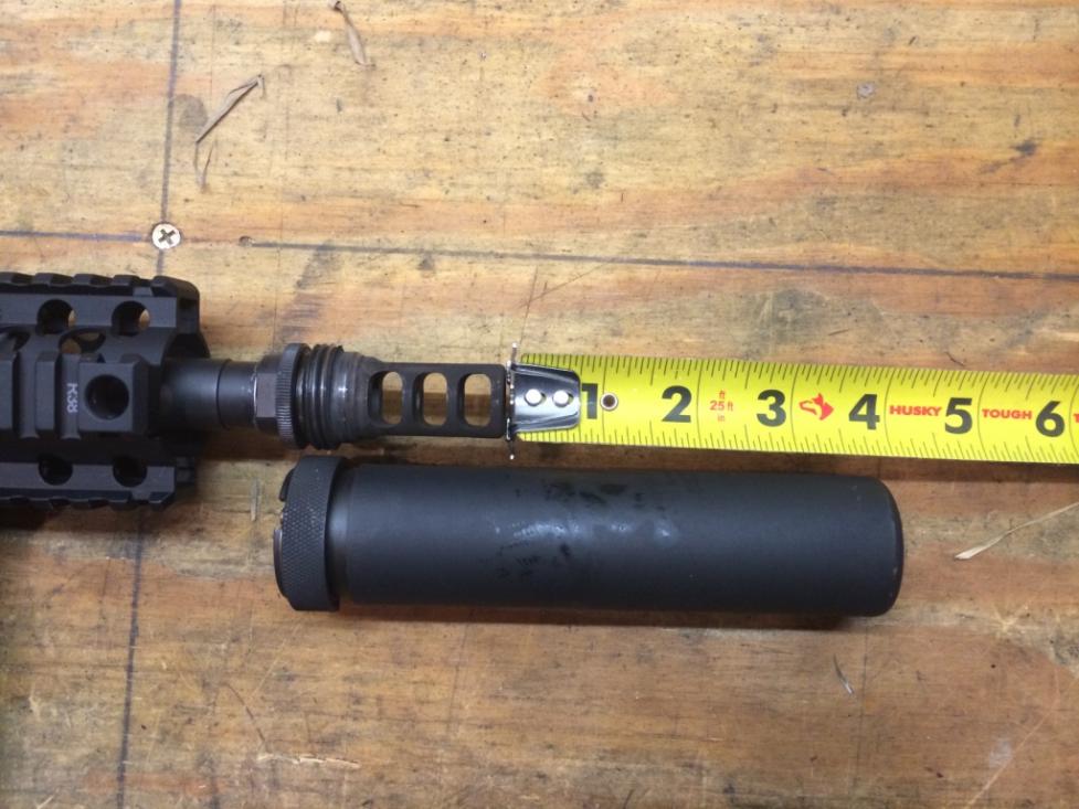

I just picked up my Specwar K last week and, so far, I really like it. The muzzle devices for these cans are 2 1/2" long overall, so they extend 2" beyond the muzzle. The can itself adds 4" beyond the brake-mount (muzzle device).

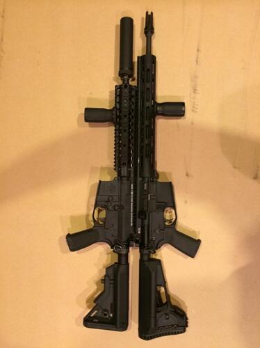

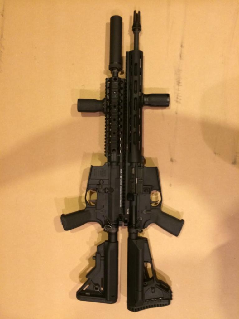

I measured the overall barrel length with the mount, on a closed bolt, and came up with 13.5" overall with my 11.5" barrel. The total barrel length with the can on is 17.5". I placed the SBR next to a rifle with 16" barrel and Trifecta muzzle device for an overall length comparison.
You will see it is still just a bit shorter. I would wager to say that with the same stock on both guns, the length would be right about the same.
