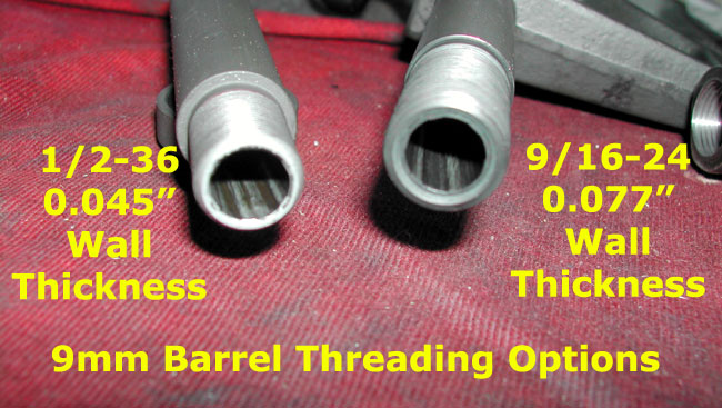

I have shortened a bunch of colt 9mm barrels for people.
I’m not really a fan of the 1/2-36 threads through as they leave the barrel really thin.
I prefer 9/16-24 or 5/8-24 threads.
I still do 1/2-36 for people that want them though.
Any 1/2-36 muzzle device can be opened up to 9/16-24 threads and you end up with a much stronger thread junction that is not likely to stretch the bore like 1/2-36 threads do when crushing a crush washer…
