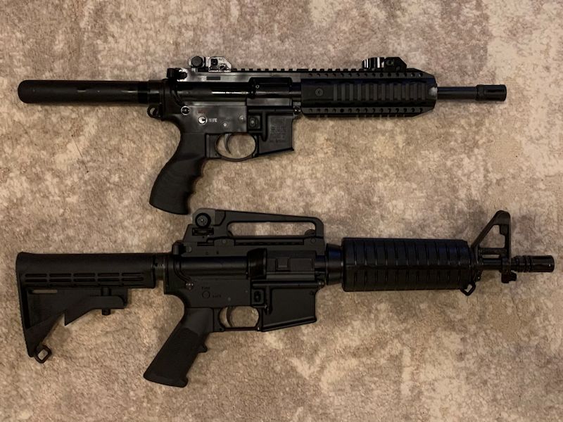

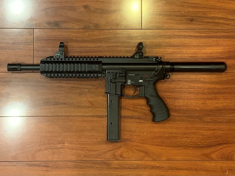

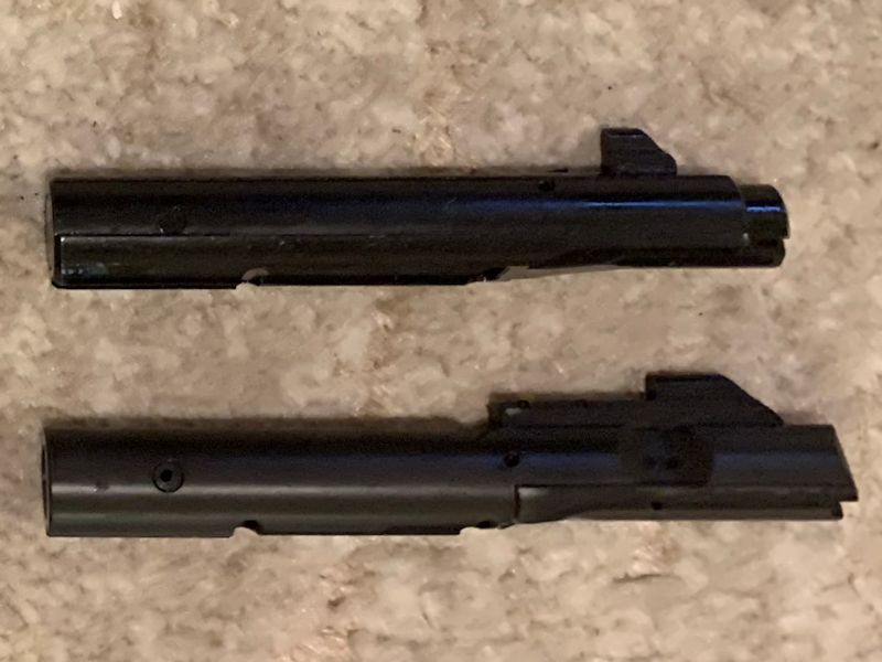

I picked up a SAR 109T today. It’s a semi pistol version of a SMG made by Sarsilmaz Arms in Turkey. When they first came out retail was $1,800. Not surprisingly, they didn’t sell well at that price. They decided to drop the price and can now be had in the $600 to $700 range. They take Colt pattern 9mm SMG magazines. In fact, this one came with three Metalform 32rd magazines. The thing that I find most interesting about it is how they shortened both receivers, the bolt and the charging handle. I will change it from a pistol to an SBR after I verify its reliability.
Here it is along with my Colt 9mm SBR for comparison.

Wonder why they did that
Thats really interesting that they shortened the receivers. I’ve been wondering why no one does that. Edit: shortening the receivers should shave an inch (based on mag size), and blowback guns are already about a half inch shorter (use a 12” barrel to use the same rail as your 11.5 556 gun). A 14.5” p/w with one of these would feel shorter than ATF-style measurement would imply.

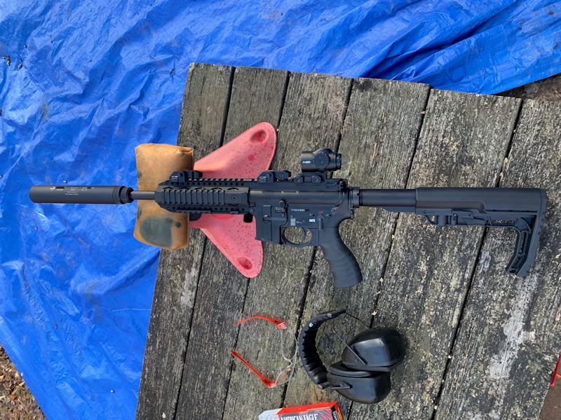

I picked up a Primary Arms SLx 1x MicroPrism for the optic. It basically works like a small ACOG.
Today I ran 50rds of Geco 124gr FMJ through it unsuppressed and 50rds of Federal American Eagle 147gr TMJ though it suppressed. The magazine is a Metalform and the suppressor is a B&T tri-lug. It ran without issue, though it was definitely gassy when suppressed.
