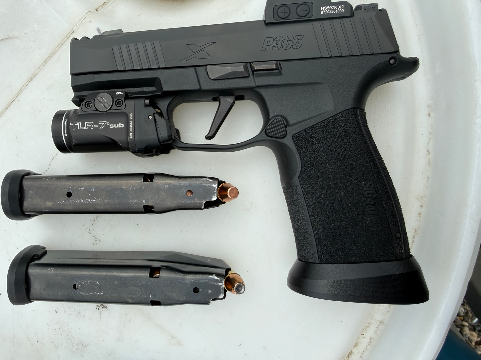

I went to my range last Friday and shot pistols. After a lot of .22LR work with my iron sight G44 and my dot sight P322, I decided to shoot my P365 Macro Comp. I put a couple magazines each of my reloaded RMR Flat Nose and NUKE 135 gr Rounds. All were loaded with 4.2 gr N340. All NUKES had CCI 500 primers. The flat nose had mostly Win SP primers.

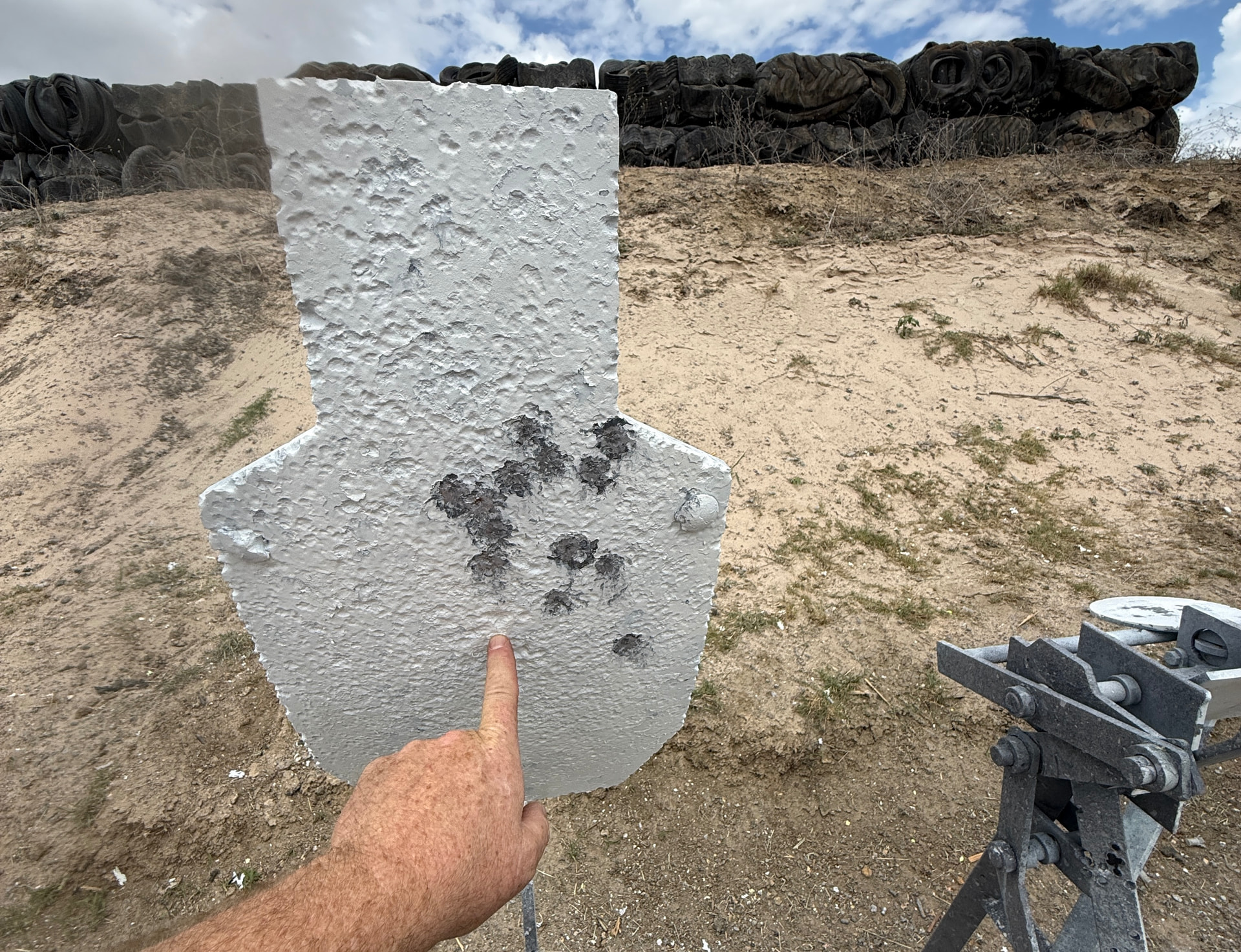

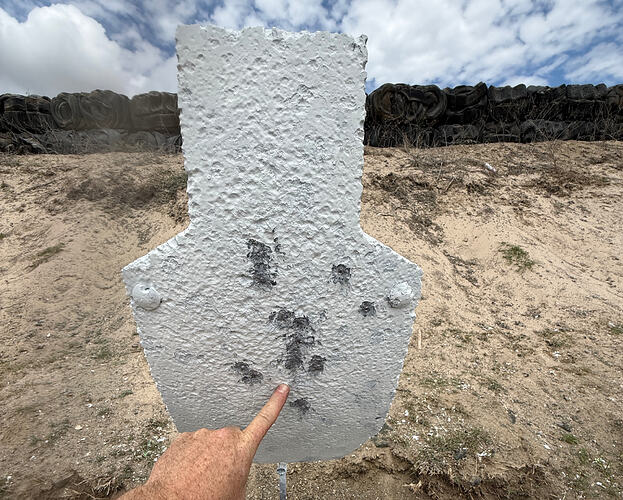

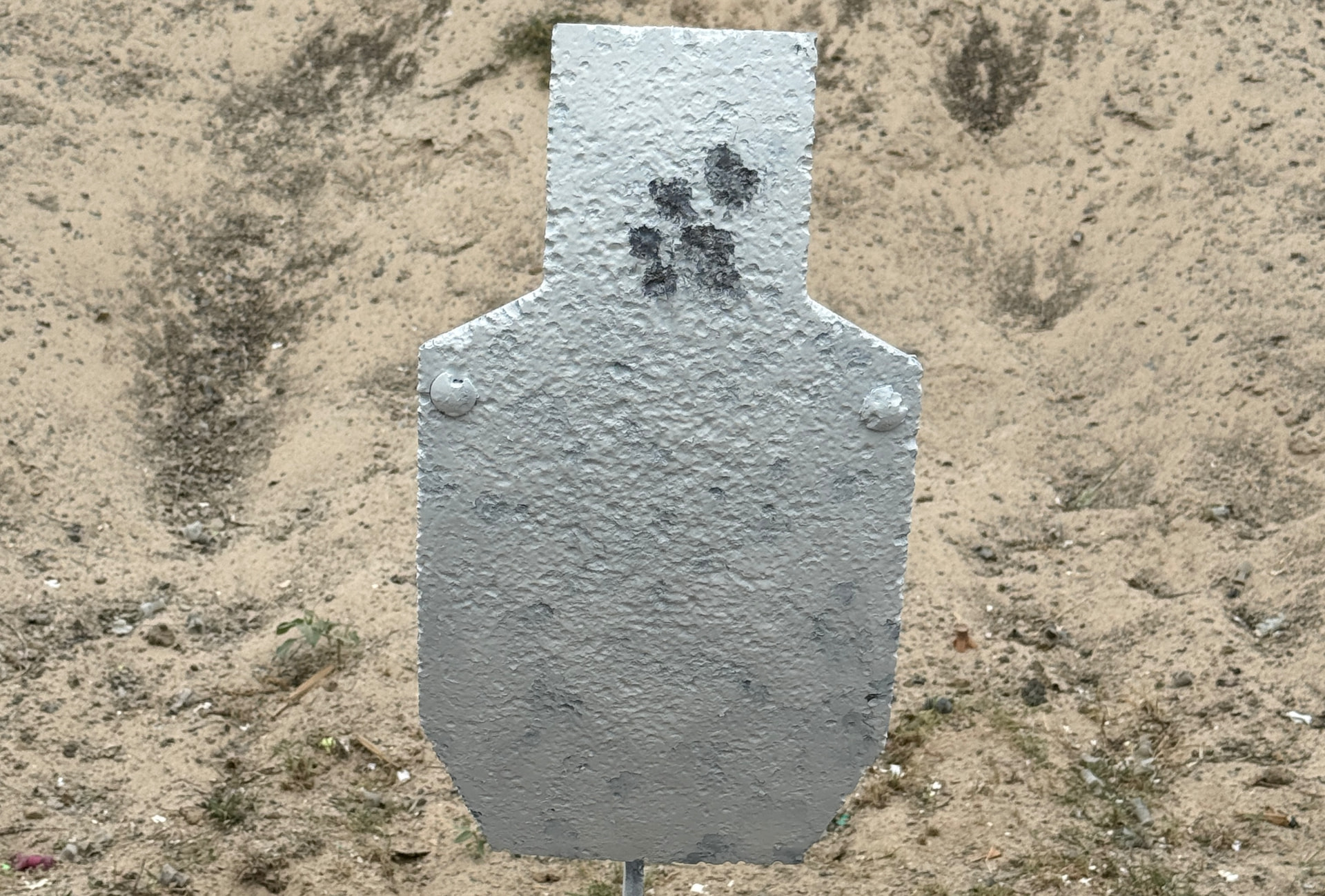

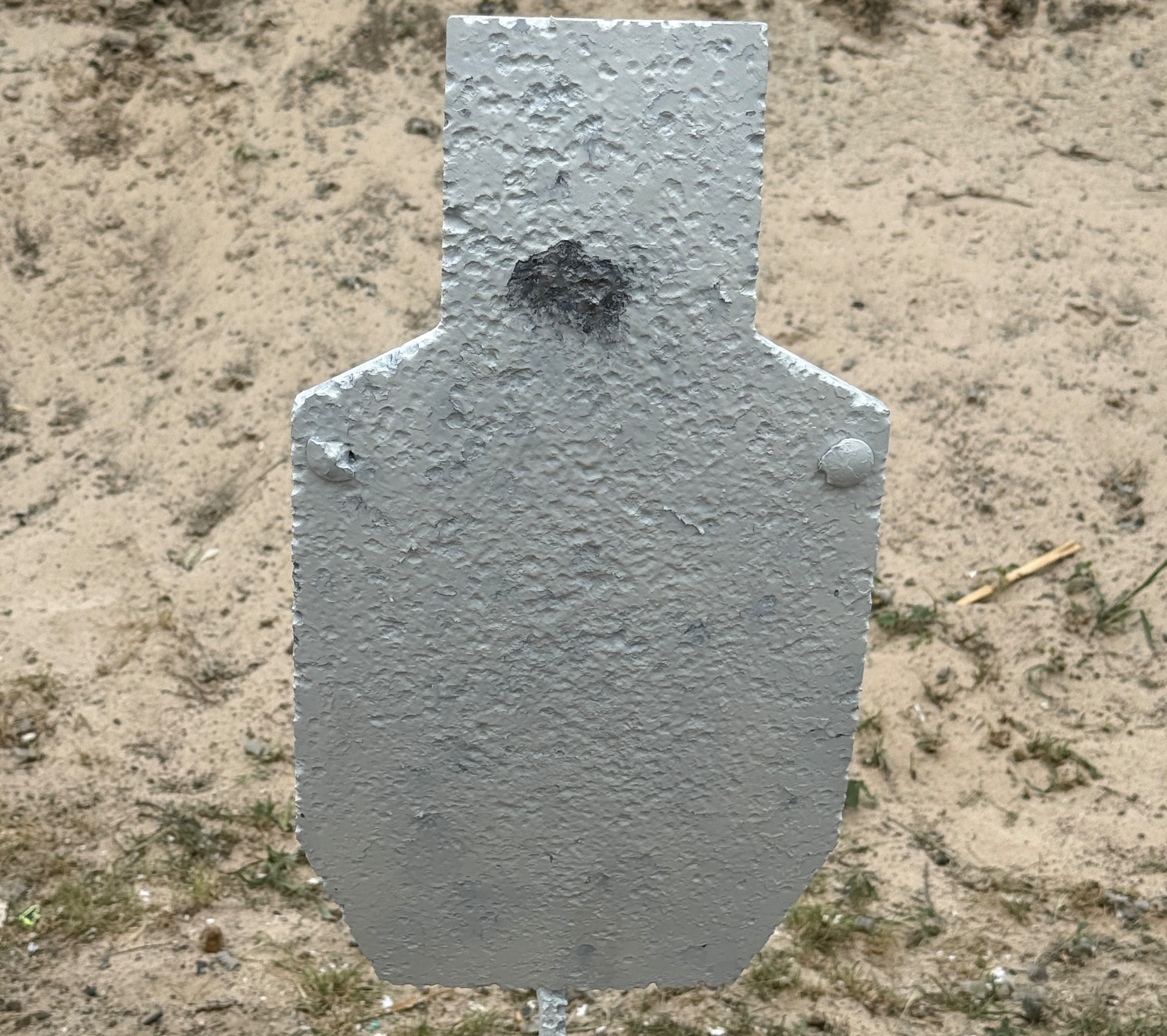

The weather was gorgeous…around 80 with a nice 10-15 breeze. Targets were freshly painted steel. First set was 8 rounds at 15 yards. Left target was FP rounds, right was NUKES. POA for the dot was centered at the neckline. All shots were standing off hand slow fire.
At 15 yards, the eight NUKES all landed close enough for one single splatter, while the FP’s grouped great but not a one splatter group.
(Bottom pics)
I repainted the steel and went back to 25 yards. The results shifted a bit. I’m pointing to my POA on each target. NUKES are the top picture. At 25 yards I prefer the FP group, but I was kinda bucking the breeze for stability through most shots and I’m definitely NOT aerodynamic! (Top pics)**
Overall, I’m VERY happy with this bullet from RMR. I think I’ll stick with the 135’s and probably continue to load both FP’s and JHP’s for the foreseeable future.

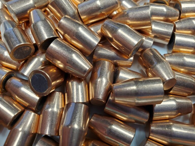

One thing about RMR FMJ pistol bullets, their copper jackets are pretty heavy and thick…these are not plated bullets. I really like the truncated cone versions because if push comes to shove, I have no qualms about using them for a “woods” carry option or even any type of self defense scenario. I’m probably going to use these when I rotate ammo in my “just in case” loaded mags.
Another reason I like this combo, I load both the FMJ and JHP to the exact same load including powder amount and bullet seating depth, so switching loading them on the Dillon from one to another is seamless. Same with shooting them.

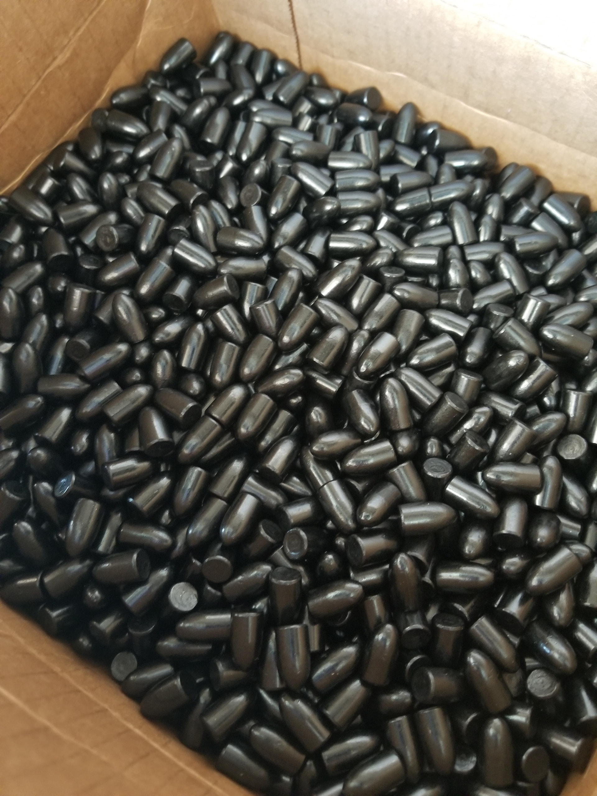

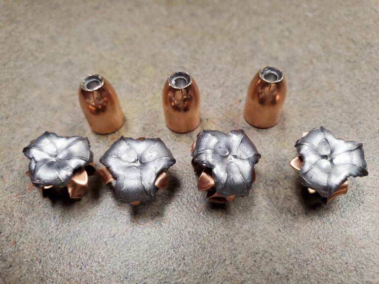

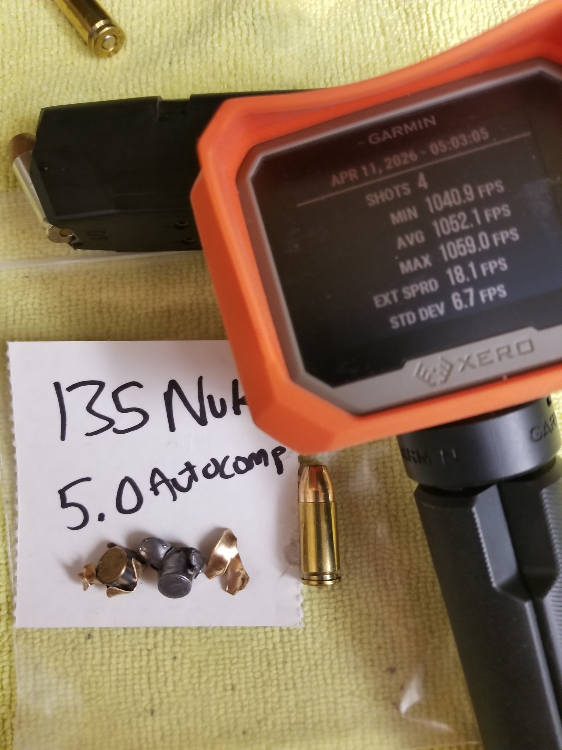

I just got mine too. I’ll piggyback on this thread. Shot into some jugs of water/freezer gel at no specific blend. They open up pretty well. As much as I hate 9mm’s weakness, the 135 gr is THE do all bullet for the caliber. It’s stays subsonic, but cycles better than the 147s which give sluggish slide speed. I load 135 SNS coated bullets at reduced velocities for Pappabear’s Atlas guns for his match shooting. It’s the perfect bullet weight. I plan to load the Nukes for Sub Gun defense ammo, not that the sub gun is my primary choice, but it’s a tool in the box.
For practice ammo Pappabear ordered 6600 of these SNS Casting 135s. I’m addicted to the coated bullets.
