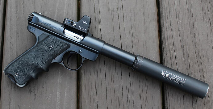

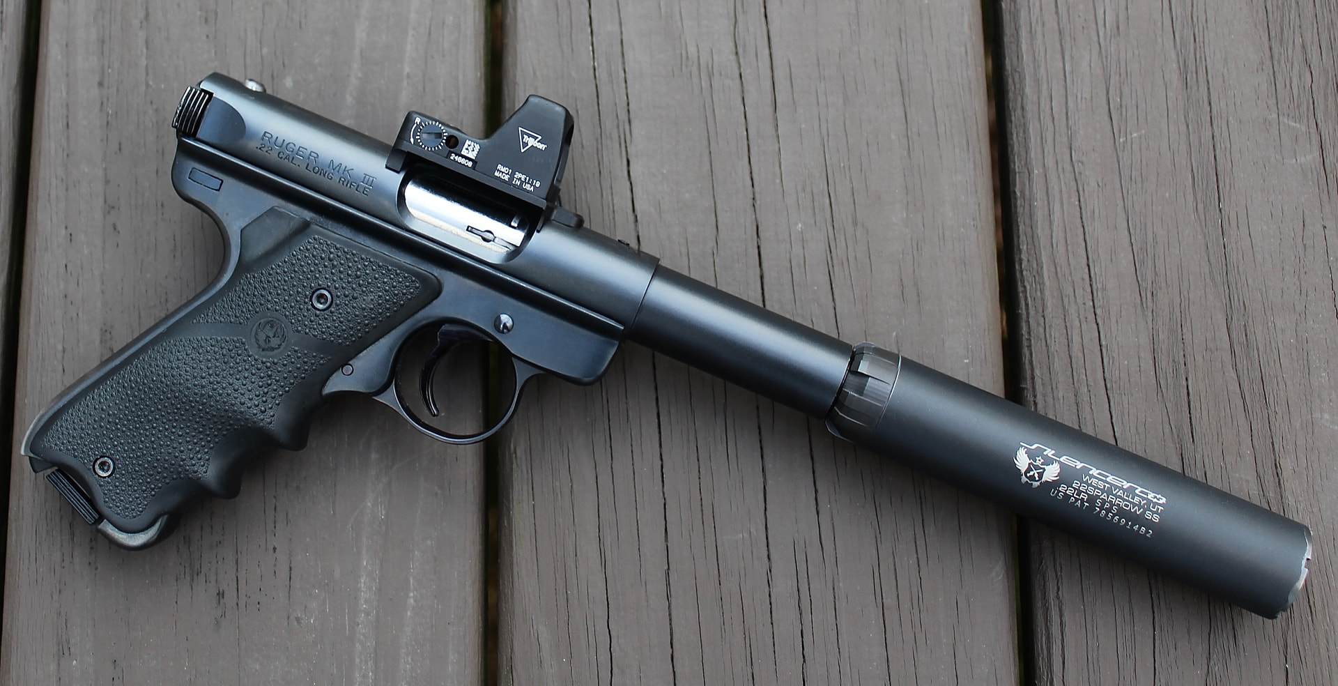

I have a two rimfire cans, a very old YHM sealed and an old Sparrow when they first came out. I pretty much only use CCI SV. On pistols the YHM has no discernible FRP due its larger volume. The Sparrow has a healthy FRP. Still, it’s not like ya need hearing protection. It’s simply noticeable. For range use (fortunately I belong to a club where I often have a range to myself) FRP is meaningless. At home… my wife can’t hear me while shooting off the back deck when she’s in the kitchen with only double pane windows between us. And no matter how quiet the muzzle blast, rabbits and squirrels are still gonna scatter upon bullet impact. Minimal FRP seems more about bragging rights than practical use, at least for me. How about you guys?

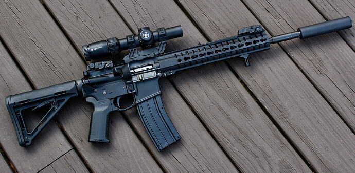

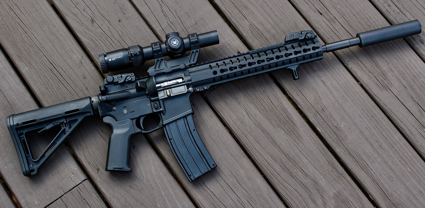

As long as ya got a place to shoot without obnoxious unmuffled guns around… suppressed rimfire is a ton of fun. My old CMMG dedicated. I use the larger diameter YHM suppressor just cuz it looks more proportional to standard AR.
