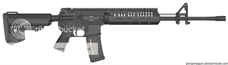

Will the Vltor CASV midlength work on a rifle. I don’t see why not but it might be ugly. Wish I knew how to photoshop the setup.

As for the graphic that is depicted above. I would ABSOLUTELY NOT run a weapon depicted like that. Aside from the potential of burning your hand you risk damage to the tube and thereby making your weapon USELESS.
no… you can’t put a midlength on a rifle. your gas tube would be exposed, and that’s unacceptable, even for a varmint gun.

Yeah. I hadn’t thought about the gas tube until I saw the graffex picture.
