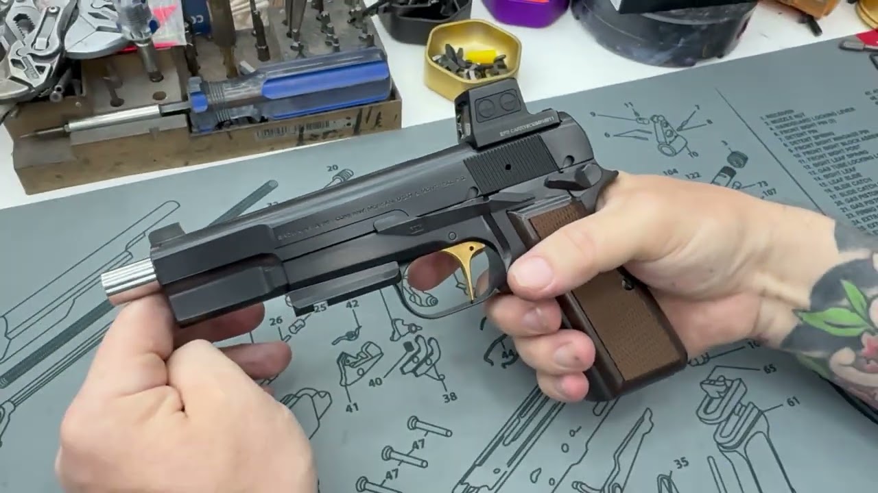

Here is the video MK3 did on my pistol.
The barrel is now back at KKM getting Block Isonite finish.
