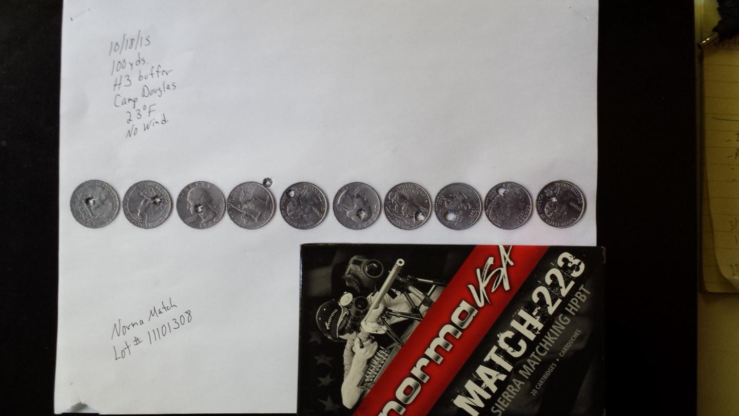

9 out of 10 hits; excellent shooting! Overlaying all ten of your “quarters” on each other produces a 10-shot group with an extreme spread of 0.74" and a mean radius of 0.24". Again, excellent shooting!

A bit chilly at 23 degrees this morning with no wind.

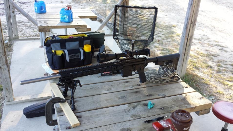

Installed an H3 buffer which functioned fine.
Got to test out the battery assist lever from Tactical Link and am very pleased.
Used my brass catcher that I use for Bullseye pistol placed at 4 o’clock position and caught them all.
Looks to be my best target so far except for the #4 quarter I could feel that I eased up on the preload of the bipod just as the round went off.
Also glad that I kept the adjustable carbine stock instead of going with a fixed rifle stock cause I needed to collapse it one position to accommodate the extra clothing I was wearing to keep my head position on the stock in its proper place.
Precision shooters need to try this target.
It is not easy but very gratifying when you do everything right.
Clarence
Another excellent run, with 9 out of 10 hits! Overlaying all ten of your quarters produces a 10-shot group with an extreme spread of 0.88" and a mean radius of 0.27".
