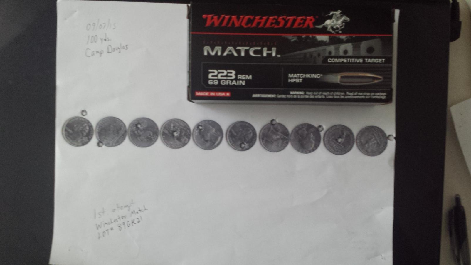

Finally got out today to break in the barrel with some cheap AE XM193 and made two attempts on the quarter targets before the rain hit.

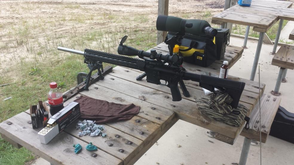

Never shot here before, should have brought a stool.
Benches too short for me and bolted down stools made it real short.
Now my excuses are out of the way :rolleyes:
Pic of rifle and best 100 yd attempt.

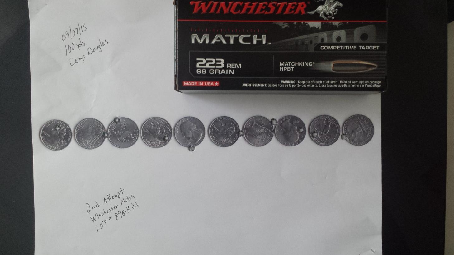

Figured I would post the first attempt also with the Winchester match ammo.
