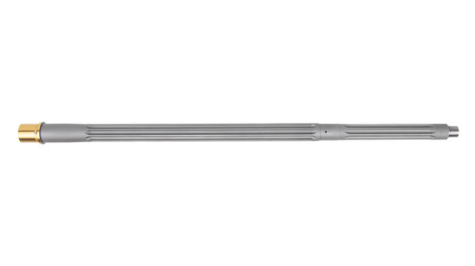

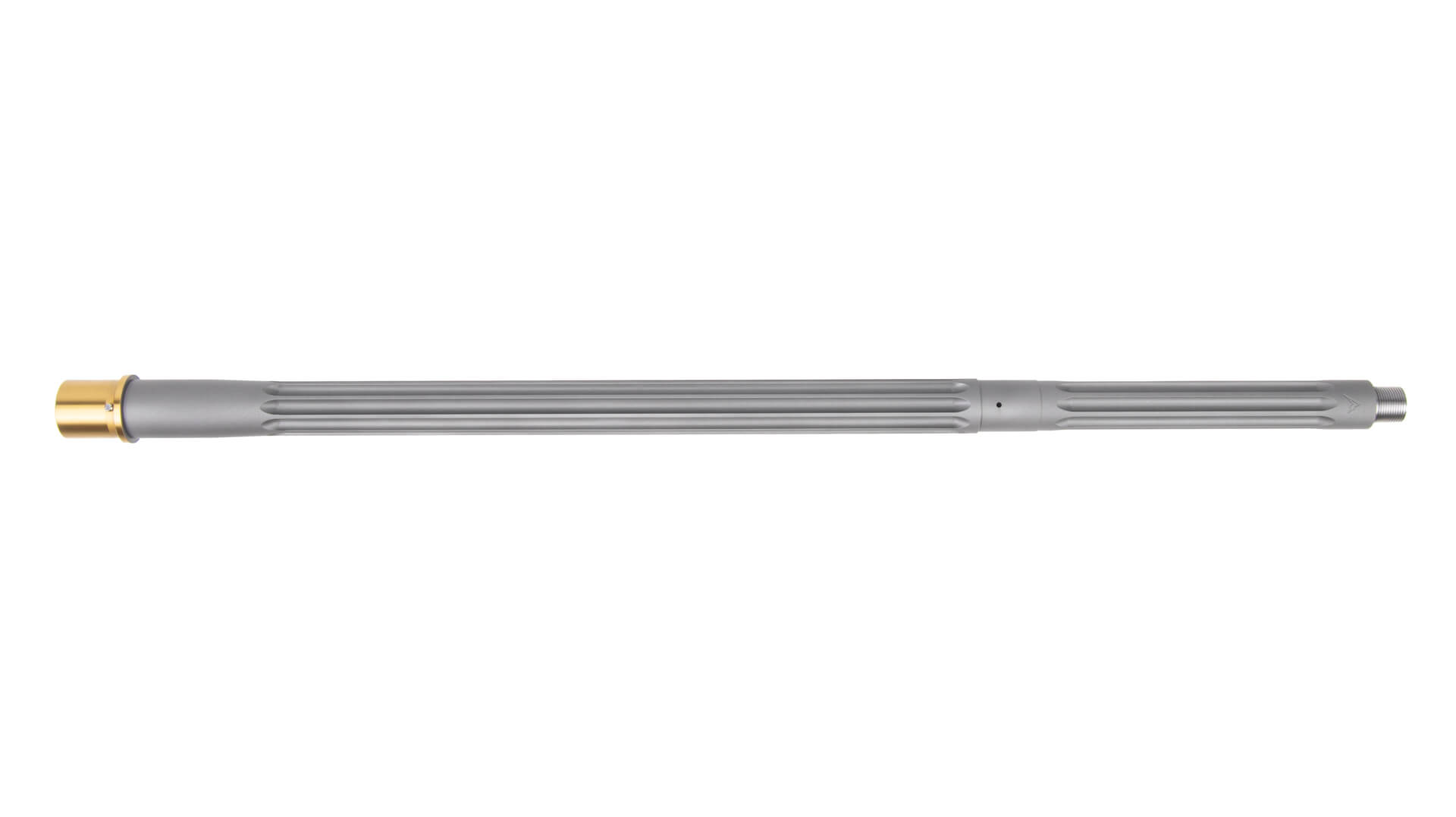

Proof 20inch 6ARC barrel (Bud’s Guns)

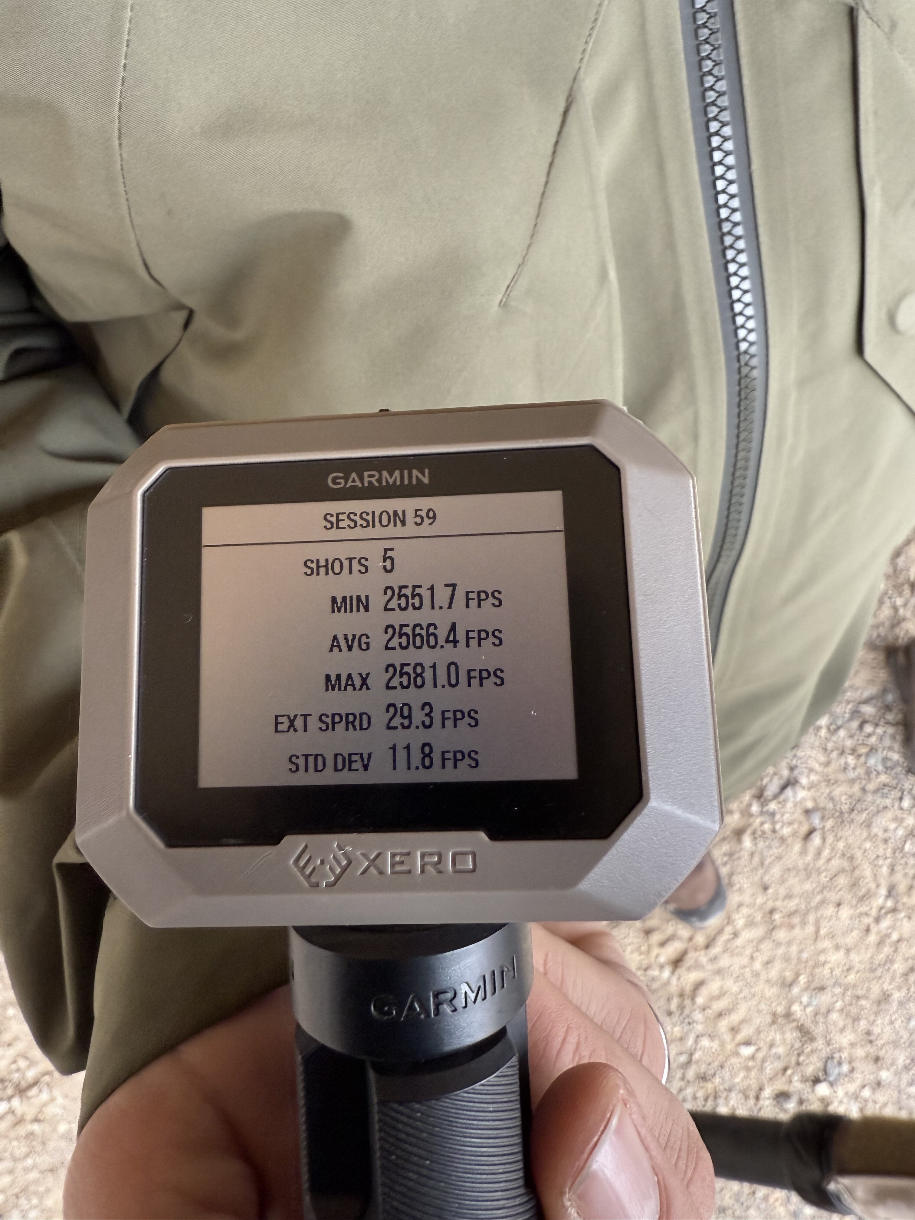

Chrono’d with Hornady 1808 ELDM
