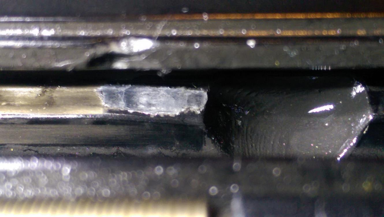

They cause extra damage if used in carbines and SBRs running cans.
Increased duration of pressure spike blows through chamber against the bolt face after unlock and causes the BCG to be pushed to the rear, tipping the cam pin into the inside of the upper.
Having the total surface area of the pin reduced from the flat fixed pin to a much smaller contact surface of the round pin creates a nice divot right behind the cam pin relief cutout. And no, i’m not talking about the typical wear leading into the relief cutout that most people complain about.

Damage pic for reference:
That’s interesting, damn.

Grumps, that’s from a POF cam pin??
If it has the the same performance as the part it’s meant to an improvement of, and doesn’t do it any better, in fact doesn’t perform as well as the factory part, it’s not an upgrade at all, but a down grade.
Maybe I missed it, did this happen on a piston or DI gun? It’s amazing that, after unlocking, the bolt face can still be hit with such force to cause the cam pin to impact the upper like that. Just goes to show how complex the operation of these simple machines really are.
