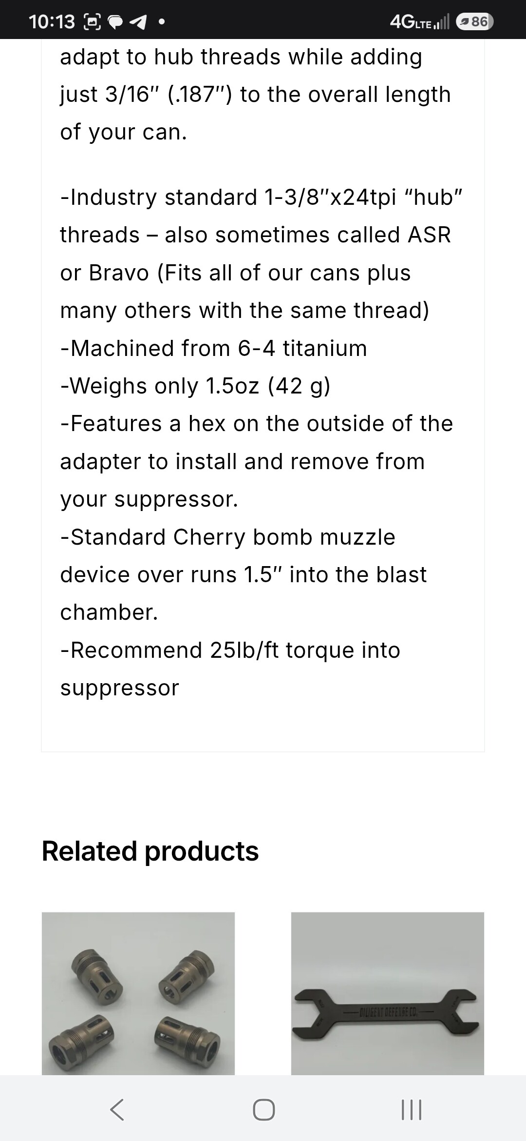

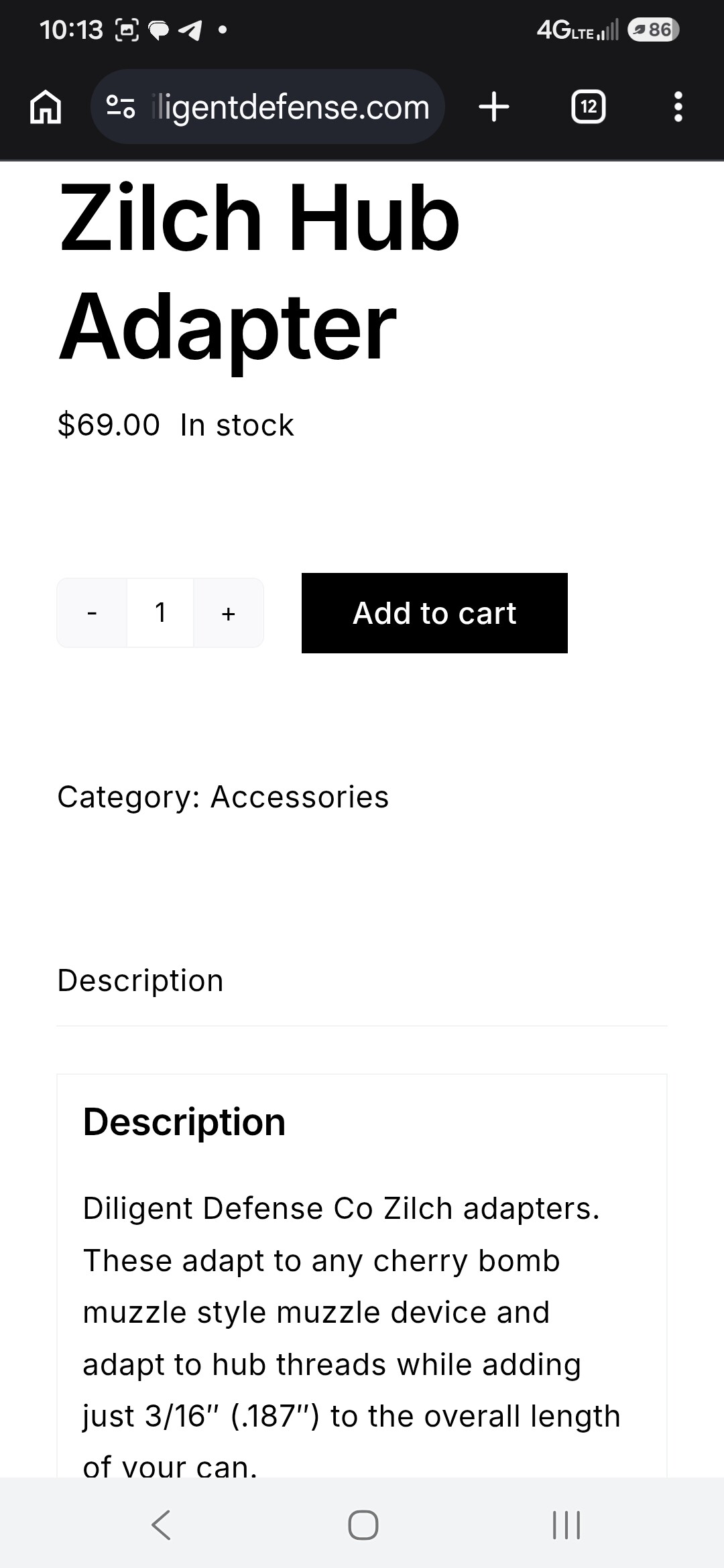

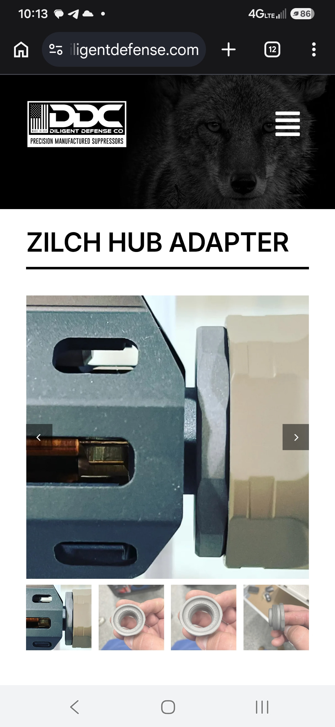

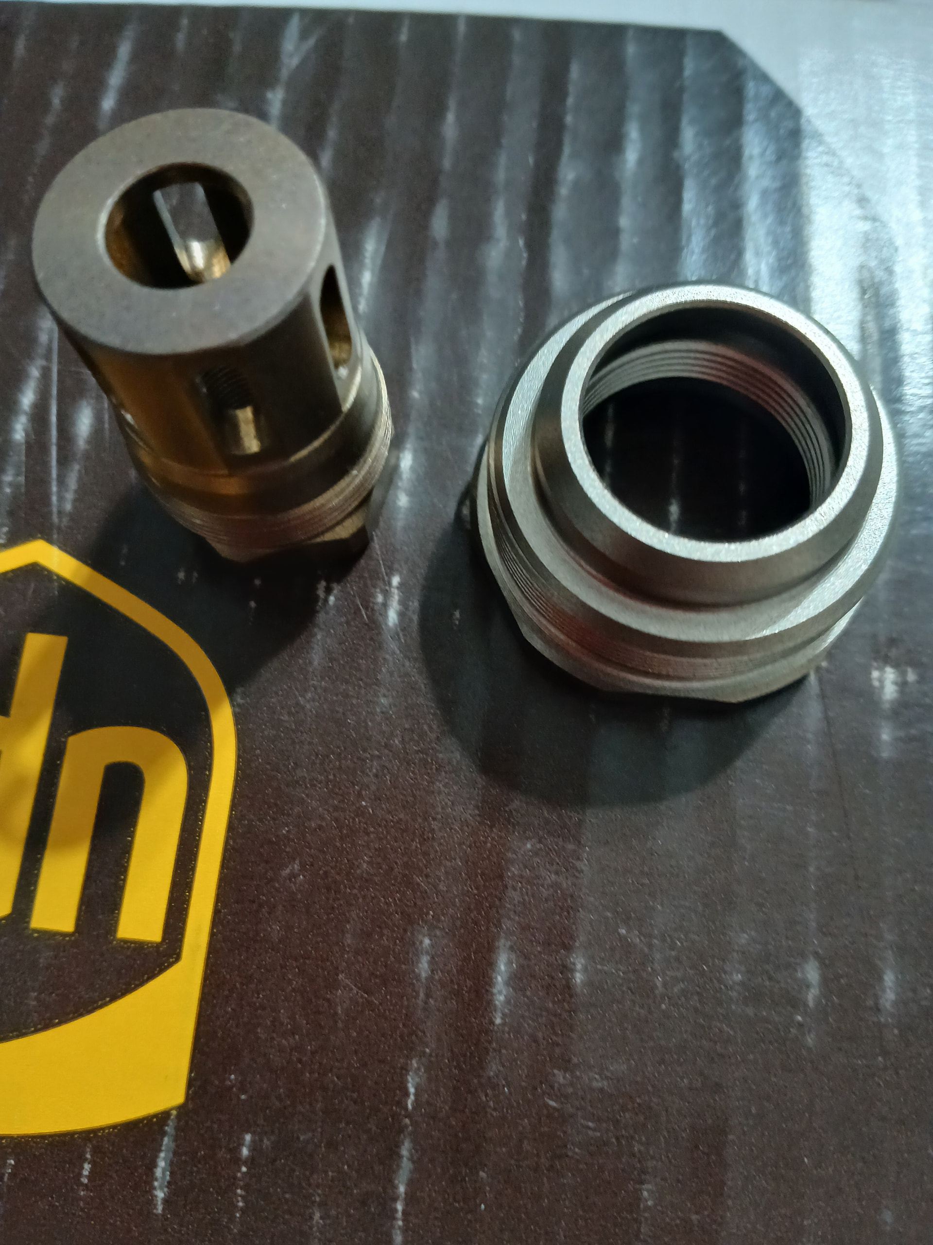

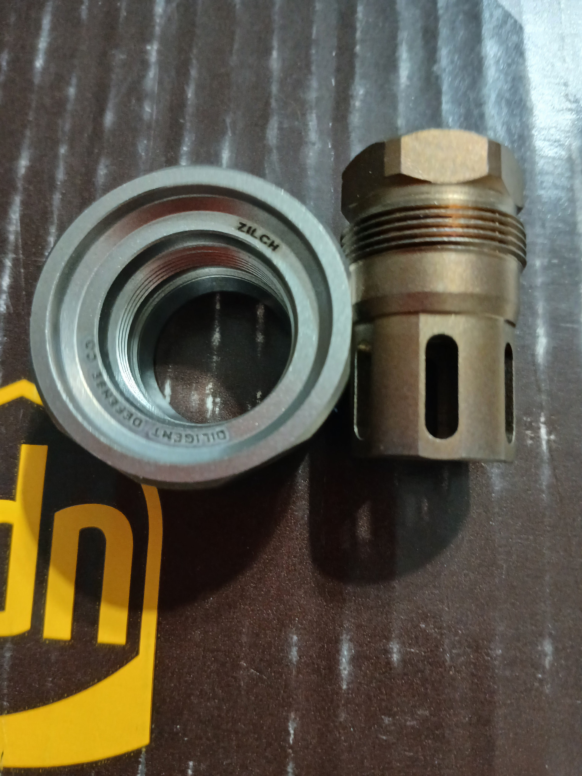

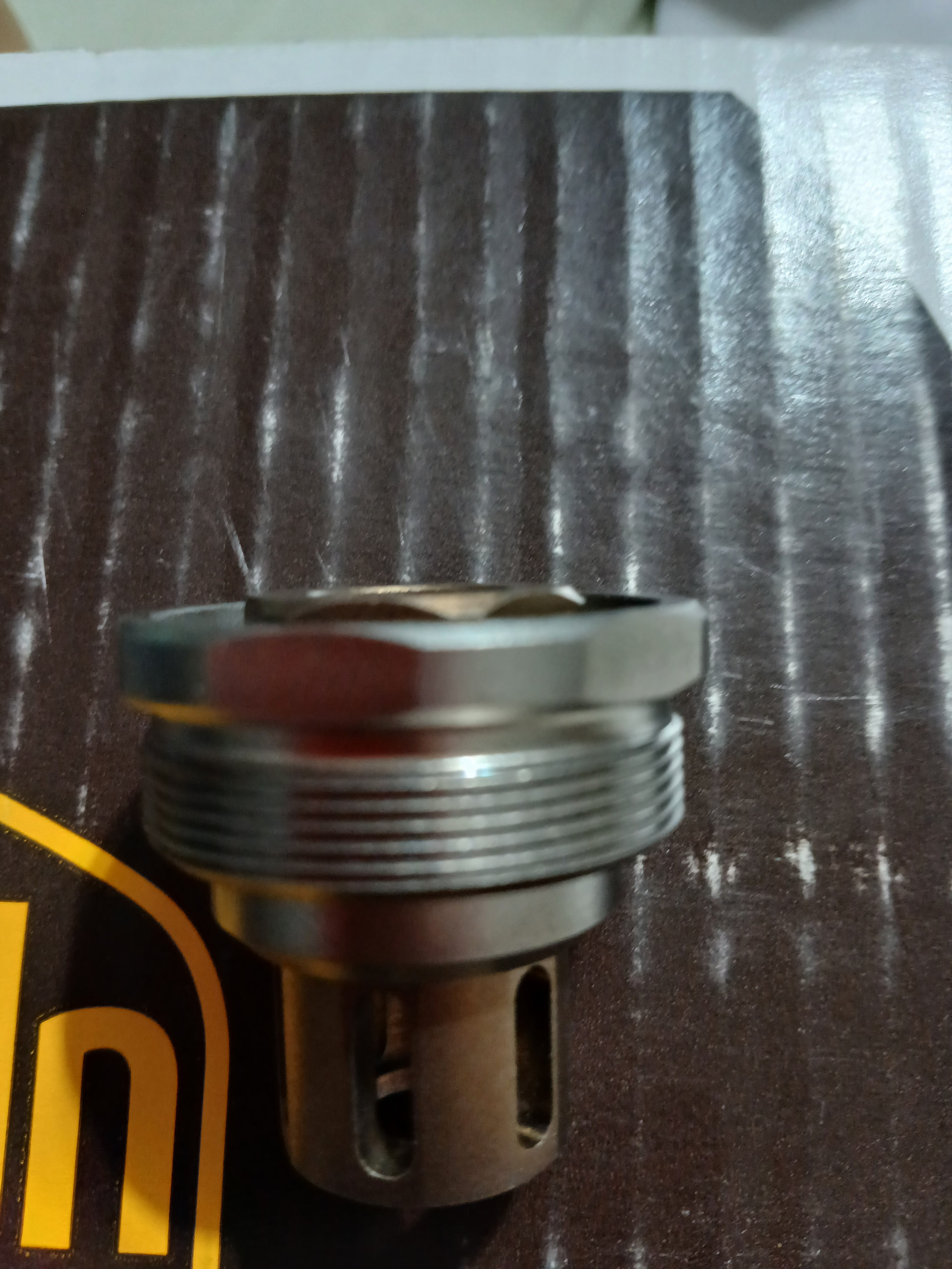

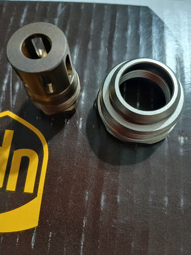

Got a Dilligent Defense Co Zilch hub adapter and their CBAH muzzle device
From Charger Arms(ordered Friday, shipped Tuesday, arrived Thursday from Kansas to Kentucky).

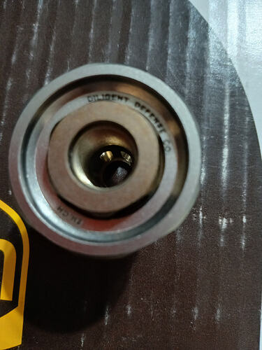

Guessing the Zilch(1.5oz) is lower profile than most direct thread mounts since this is slightly recessed and comes within less than 3/64" of being flush with the CBAH brake(1.9oz) so I am happy with the size and weight.
CBAH heat treat only finish is fairly dull in person. Think burnt bronze or some batches of desert dirt that ALG rails used to come in.
Will try to get some shooting in soon and see if it works as advertised.
