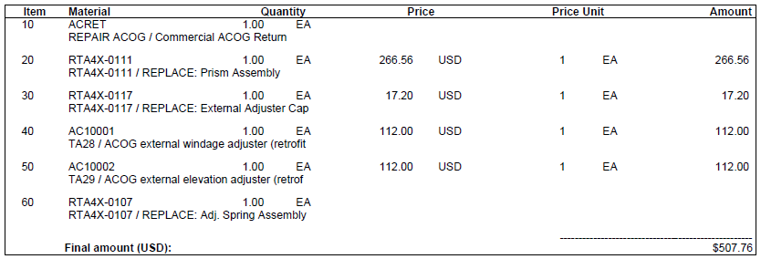

This was for an April 2024 TA01Tritium re-lamping. It was a little expensive in that I replaced the centimeter coin-slot elevation and windage adjusters, changing to 1/2 minute click turrets. They changed the 5.56 BDC to 7.62 for free.
Bottom line – a tritium re-lamping was under $300. Took three weeks.
