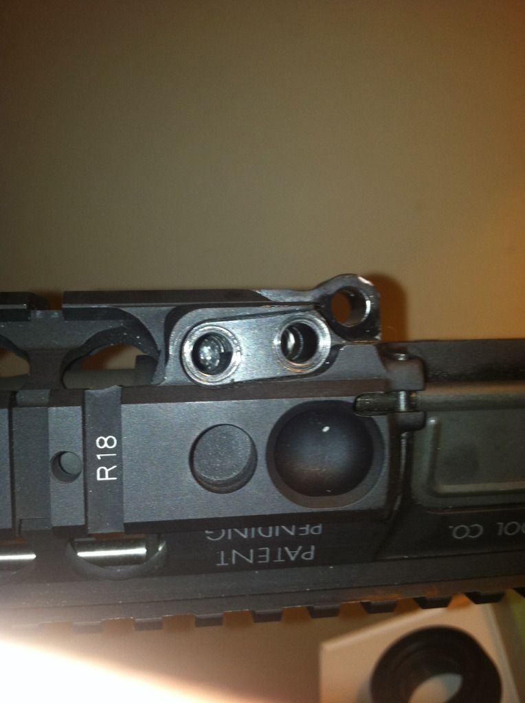

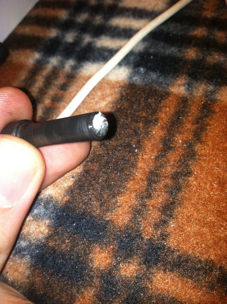

Oh snap, there went my torques T-30 head on my LMT.
Since Craftsman ain’t up to the challenge, anyone with an LMT MRP, or uses torques heads extensively recommend me a much better set to take the 140 foot pounds? I just did a big clean up on my LMT MRP upper, and was about to tighten it down until snap!
Also, any good torque wrenches?
INCH pounds, dude…140 INCH pounds (a little over 11.5 ft/lbs).
Catch a Snap-On truck and grab one of their 1/4" drive Inch/Pound torque wrenches and one of their impact-rated 1/4" drive T30 bits (or Harbor Freight for that one) and call it done.

Wait…did you break the wrench or the bolt?
I went down this road details are in the MRP thread, I bought 6 replacement bolts from Ryan but since I got my new wrench I have not needed them.

Thanks everyone. Yes, it was the bolt head that snapped. Actually, it twisted, then snapped. I still don’t think it got to the proper torque.
Here is something else. Last time I did this I torqued it down by hand and feel. Did the 1/4-1/2 turn after hand tightening, and I am pretty sure a little more. I went to loosen the first bolt and it came off pretty easy, which scares me. It was tight, but not that tight. I was having some minor accuracy issues with it (Not getting great groupings) and was wondering if the torque screws might have been loose. The front was, the rear was still tight.

I wound up slotting the other side of the bolt with a dremel and backing it out with a flat headed screwdriver. Then I bought the snap on wrench.
