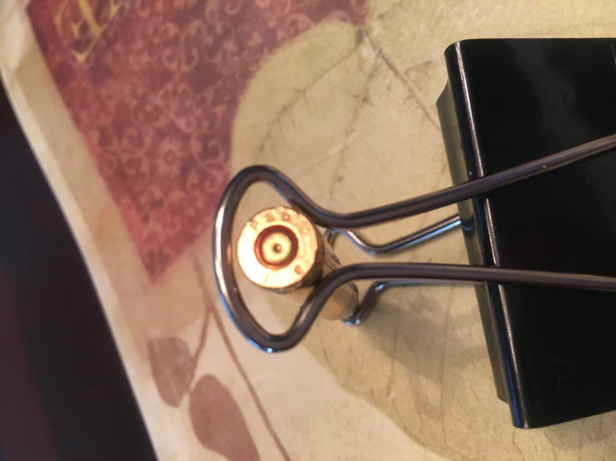

So I took out a rifle today that had never had any misfires or issues before, and I got several clicks without a bang. It also emptied several magazines without a hiccup. I have attached a picture of two rounds which did not fire. Does it look like the gun is making light primer strikes? All in all, I had about six failures to fire. I had some Remington UMC ammo. It also fired some PMC . What do you think?
Looks right on the edge of light…but you nailed them several times, so probably not light. I suppose it’s possible that the cases were short and caused a head space issue, pushing the case a tiny bit more into the chamber thus absorbing some FP energy. 6 dead primers seems unlikely, but might happen.

OP, did it misfire with both PMC PSD and Rem UMC? The pictures show PSD rounds with light primer strikes.
