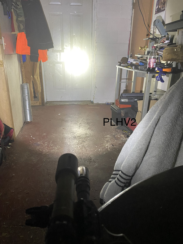

Here’s some inside beam-shot comparisons…
As you can see the P60VNs beam profile is almost identical with the PLHV2, but it does have more throw.

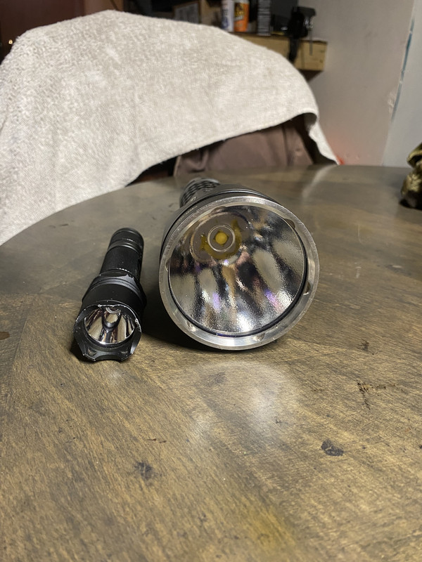

This S2200 is still a beautiful beast. People don’t understand how well this light was actually thought out. They took a very large die led (MT-G2) and made it throw a wall of light further then anyone at the time thought was possible with such a large die! All driven at very safe 2a.
Wow!! That’s a beast! I never tried any non-6p Solarforce set ups. I was always scraping by just to get the 6ps at that time.
