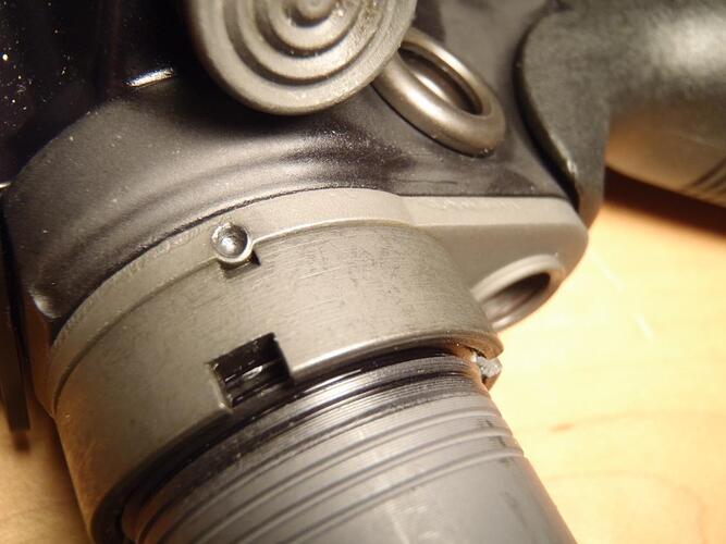

Is this staking enough?
I think it would have been good on an in spec castle nut. The staking notch on yours appears to be wider than 0.84 + 0.020 though.

I think that would have been a good stake if the castle nut was correct. The notch isn’t letting metal displace effectively. The notch is so shallow where it touches the endplate that no metal gets to where it would interfere with rotation.
Up to you if you want to redo it. If the castle nut was torqued properly to 40 foot pounds it will probably never ever loosen. But if probably isn’t good enough, buy a milspec nut or Duffy’s nut and re do it.

That’s a good looking stake right there. Wonder why whoever made these out of spec nuts made them that way, it’s probably cheaper to cut a 45 degree notch than that oval depression. Probably MIM or investment cast so it doesn’t matter. Still, why not do it right?
You’re good. Quit worrying.

Seriously, try to get a little more displacement with the second stake and you should be GTG.
I don’t like re-staking an endplate the marks from the first stakes are just off putting to me, so I use a new one. Only a couple bucks unless you are rolling a QD endplate.
Get a little more displacement on the other one and it will be fine.

I had mostly seen these ridiculous castle nuts on DD ARs, and my opinion of them has always been “shallow oval depression a staking notch does not make” In spec notches are angled for good reasons, whether the original designers realized it or not. A shallow depression makes it hard to displace material from the end plate to the “notch”. All the while, I don’t think a properly made castle nut, (doesn’t have to be 4140 PH billet, black nitrided castle nut expensive and over built) doesn’t cost more to make than these out of spec castle nuts. So why not do it right, unless they’re in the same category as Strike Industries that don’t shoot or know the weapon they’re ruining.
