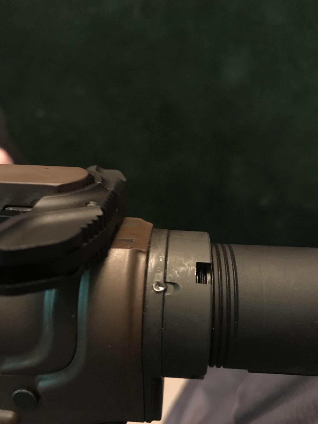

Is this staking enough?
I staked my castle nut in one place is this enough to hold it tight?
there are usually two slots available. Stake the other one too.
It could just be the picture, but I don’t think you displaced enough metal outward into the notch to hold.
Best way I can explain is start with the an auto-punch straight, make a good indentation then angle the punch to move some metal over.
Also, you want to stake it in two places.
That castle nut looks wrong. Maybe it is the picture playing tricks on me. Not sure how any material from the endplate could be displaced into the notch. The notch looks cosmetic, not functional.

That’s exactly how I do mine and they’ve always turned out great. I just use the cheapo auto punch that Lowes sells and they work well enough and aren’t expensive.
OP, I think if you just used an auto punch once or twice at a slight angle the stake you already have would end up fine. As mentioned though I’d stake it twice.
I agree 100% with these two comments. To answer your question, NO.
That’s basically it in a nutshell and what I would have typed.
Completely agreed, there doesn’t appear to be enough metal displaced to be functional.
The problem is the castle nut. Not sure who is making those but a few manufacturers are using them and they are not being made correctly. The staking notches should be roughly a 45 degree angle.
Daniel defense is who made the lower and parts. What exactly is incorrect about the castle nut so I can let DD know? Also is this better?
I knew it was a nut DD uses, and it’s out of spec. TDP castle nut staking notches are angled at 45 degrees, and 0.07 long.
Factory, in spec castle nut on left, ours (CNF prototype) on right. We changed the staking notches from 45 to 30 degree to get make them longer and deeper.

This is the correct answer. Double staking.

The looks like the crappy castle nut LaRue was selling too. The notch made it very hard to move the metal enough, so mine doesnt look too much better. Using the castle nut from Duffy was perfect.
Yes, it is plenty. Its only meant to keep it from loosening and you moved enough to prevent that.

No it’s not. There is virtually no displacement there. Just ask some of the people in my last few classes who found out the hard way.

A castle nut installed backwards (cough Les Baer), unstaked castle nut secured with thread locker (or not), all are just bad news to me. There are those that maintain they torque the hell out of the nut and it never came loose. The torque value is 38 to 40ft/Lb.
I’m not here to plug our castle nut (CNF), but can use it to illustrate the importance of proper staking in our opinion. The whole reason it was created is completely centered around secure and solid staking, it involves the change of staking notch’s angle from 45 to 30 degree to create a deeper and longer staking notch, and increase the number of staking notches from 3 equally spaced to 4 equally spaced notches. The idea isn’t to stake the castle nut in more than 2 places, but to accommodate some end plate/sling adapter that covers up to 1/4 of the castle nut’s circumference, making it impossible to stake the nut in two places.
At the very least, an in spec castle nut will allow proper staking in two places when most end plates are in use. This shallow oval shaped depression doesn’t qualify as a staking notch.

I redid it will this be better or should I redo the whole thing?
