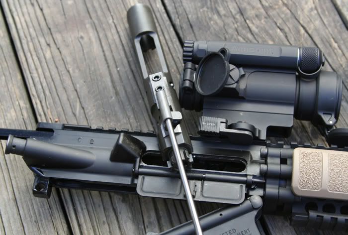

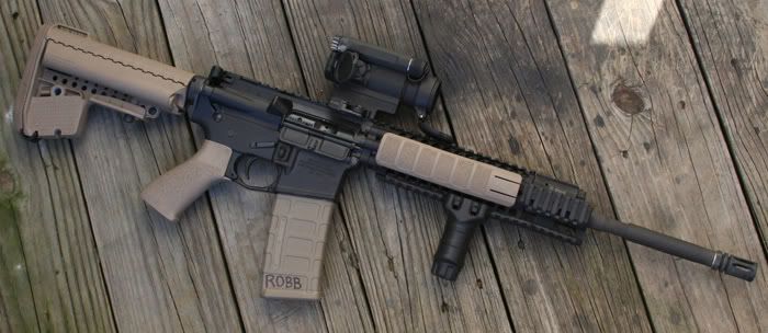

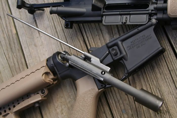

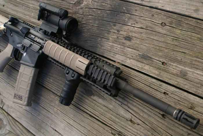

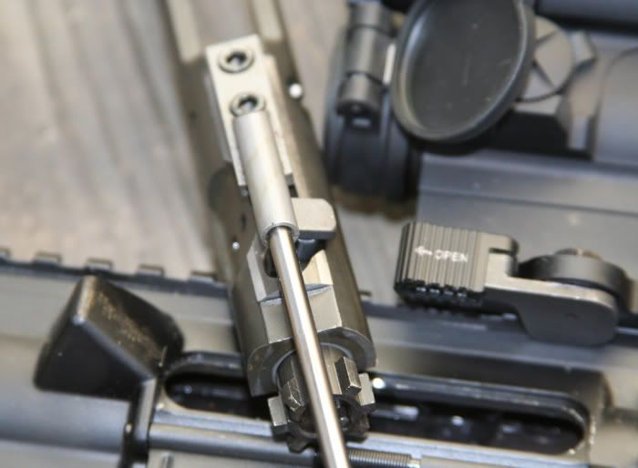

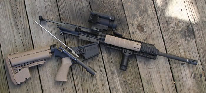

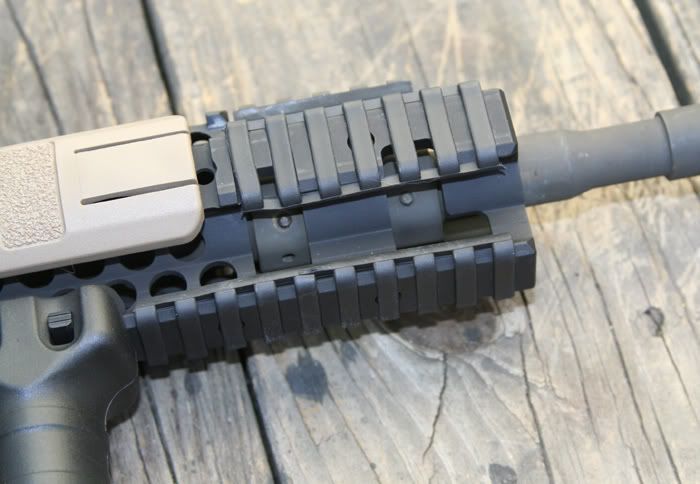

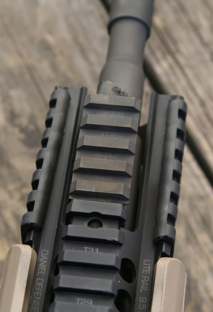

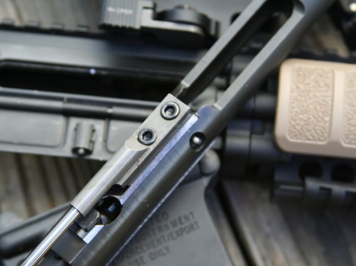

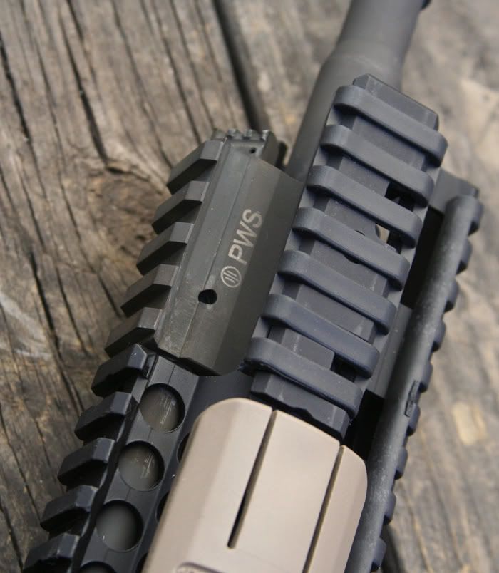

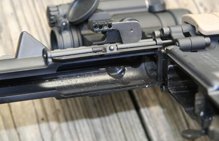

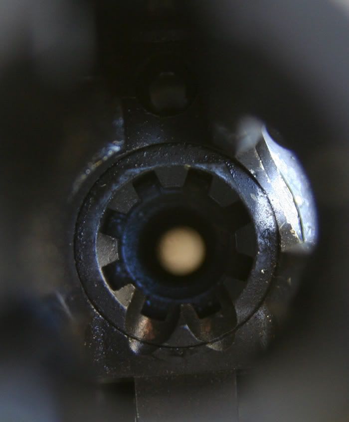

This is my initial range report on my Colt 6721/6920 hybrid which has the Primary Weapons Systems piston kit installed on it. It’s a very nice kit, retails for around $399.99. It features an adjustable gas system with a pinned gas block. The piston is in the gas block and the op rod is attached to the carrier key. The system uses your existing carrier. Primary Weapons Systems removes your DI key and replaces it with their key, with the op rod attached to it. The PWS is the lowest height I’ve seen for a piston driven kit, so low that it fits under many different rails to include the excellent Daniel Defense and LaRue to name just a few, it’ll also fit under plastic M4 handguards.
I fired just over 350 rounds with it, in about 45 minutes, at the NRA Range; 200 of that was Wolf graciously donated by M4C member themadhatter (thanks dude! :smiley: ). The other 150+ rounds was a mix of plastic cased Natec (yes the really weak stuff), American Eagle, Guatemalan, XM193 and some other stuff. It had 2 jams. One with Natec which was a weak round which didn’t get ejected, I could tell by the recoil that the bolt didn’t move far enough back for ejection. The other was with XM193, an empty was ‘stovepiped’ in the upper with a live round below it, this one I can’t figure out if it was ammo, the rifle or shooter induced.
I used 5 different PMAGs for the shooting that night and had it generously lubed with WeaponShield. The Wolf ammo ran flawlessly and was a mix of polymer coated and lacquer coated.
The only sight used during the initial test is an Aimpoint. I sighted it in quickly at 25yds for a 1" low POA/POI and didn’t shoot for groups, initial testing was just for function. The Aimpoint on the gun is my M4 T&E model, I’ll be doing a write up here on M4C about it and my T1 very soon. There are no iron sights installed on the rifle currently. I’m waiting for my LMT front sight on backorder. I’ll be using a LaRue rear sight. I’ll update this post from time to time with my findings. The bolt is a BCM unit with a 0-ring, no gas rings, BCM cam pin and firing pin. Carrier is a Colt M16 model. I ran it with a H2 buffer. I’ll also be testing with a Enidine buffer, H buffer and a H3 buffer. I also plan replacing my A2 compensator and getting another AAC Blackout flash hider for it for testing with a my M4-2000 Mod 07 suppressor. I plan to use it on friends registered M16 within the next few weeks. The balance is very good with the VLTOR E-MOD stock, I tried one of my CTR stocks on it but that made it feel muzzle heavy.
I didn’t clean the rifle after shooting at all but did wipe off the carrier with a paper towel while showing it to some customers yesterday at the shop, as it was oily not really very dirty.

Good initial review and even better pictures. I am interested in this system and will be looking forward to your updates.

PWS doesn’t stake the gas key? Any potential problems with that in this system?
Since the carrier isn’t getting heat-soaked, Red loctite should suffice and I suspect they use just that.
I suspect the replacement key is too hard to stake anyway if it is anything like the Leitner-Wise.
