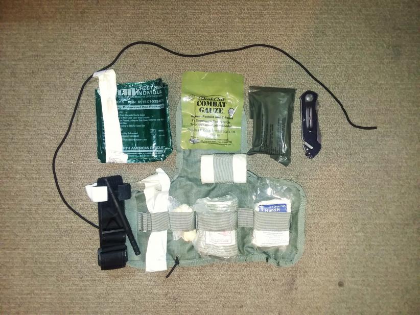

A brief IFAK packing pictorial I made. Follow link, look at the pictures and come back with questions. Remember that IFAK is an individual first aid kit, and TECC is more aid bag oriented, so some of that stuff may not fit in a belt or IBA mounted IFAK. If your CAT is still in its wrapper, you are wrong. You can attach extra CATs to MOLLE or belts with a rubber band or put it in a flashbang pouch. The guaze in my kit is Quick Clot Combat Gauze, z-folded and vacuum packed. The compression bandage/pressure dressing is a .mil issued ETD/Israeli 4” Emergency Trauma Dressing, with the outermost wrapper removed.
https://imgur.com/gallery/fnQSjjg

All my CATs are out of their packaging and have been refolded for one handed application.

There are smaller options for trauma dressings such as the thin packed H bandages, mini-Israelis, flat packed OLAES.
Hemo gauze is packed small, and almost everyone makes non-hemo gauze that’s vacuum packed to the size of a deck of cards or smaller. Or thinner like the Z-Pak.
For compression, carrying small rolls of esmark, thera-band, or SWAT-Ts is much smaller than trauma dressings or control wrap/ACE.
Nothing wrong with a bunch of wraps and gauze in lieu of packaged trauma dressings. And it’s much more flexible.

Good info here already. Regular gauze can be a bit bulky and space is at a premium in most of my kits, so compressed gauze makes sense. I’ve had good luck with H&H Flat Compressed Gauze and recently picked up some of their Tacgauze, which looks promising. It’s impressive how much gauze material can be compressed into the vacuum packed envelope.

I would say your small IFAK is too small, you either need to squeeze more stuff in or get a bigger pouch. I know you’re looking for smaller options but you need to make your pouch fit the gear then the other way around. The stuff doesnt need to fit neatly inside, squeeze anything you can fit inside. I always carry at least two IFAKs set up as follows:
In a standard USGI IFAK
CAT Tourniquet
NPA
Gloves
Israeli Bandage
Roller Gauze (Kerlex)
3in Silk Tape
14ga 3 1/4in needle
Chest Seal Gauze
Old style field dressing
Trauma knife or shears
I can also squeeze a cravat inside. I think your set up with two chest seals is okay, but why not get a needle in there? I would also add more compressed or roller gauze (Kerlex). Like three or four more rolls at least; if you need to pack a an arterial bleed you would easily use at two if not more. I also carry two extra pouches just for kerlex and CAT’s on my medic rig. You look to be on the right track, though I’d say lose the blanket, that is something more suited for a pack, rather than and IFAK, the space it takes up could be used for kerlex or a cravat. I know roller gauze is bulky but its far easier to control your roll and handle it in an efficient manner when packing a wound. Hemostatic gauze is fine, but its expensive and if you cant afford it, you can use kerlex instead. You dont need hemostatic gauze, its just really nice to have and gives you an extra edge. I didnt see if you have tape, get some tape.
