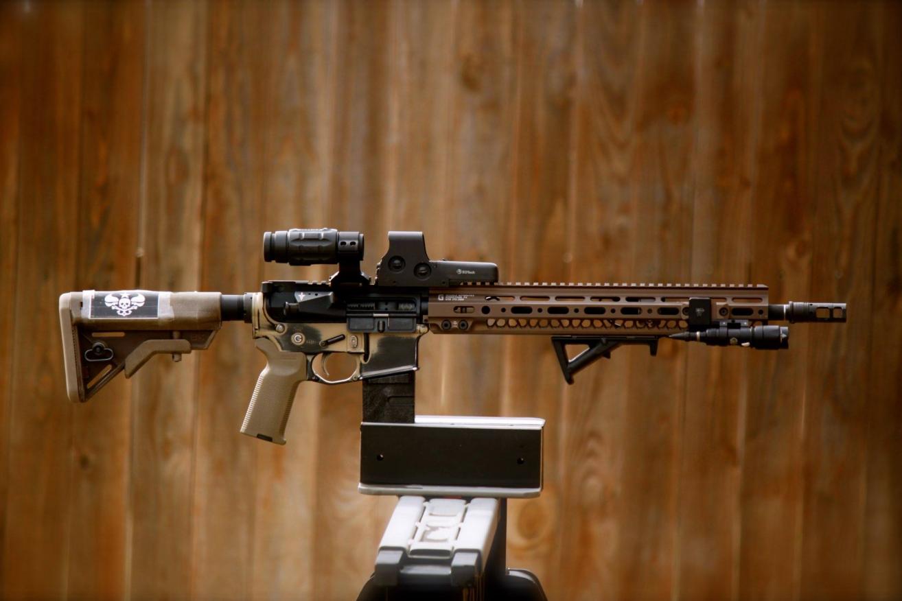

hey gents,
im running a BCM 16" barrel with a middy- gas system (using a Geissele low-pro gas block). i have a SF SOCOM muzzle break and want to attache a SF can on it but i was wondering if anyone could shine some light if there maybe some issues off the bat? i know 556 guns can be, at times, finakey so i figured there are a lot of smarter guys out there then me so. in sumarry:
  1. running a can on a 16" middy barrel, is if feasable?
  2. any issues right off the bat (e.g. cycling, feeding, etc…)
  3. any specific ammo that can help?
