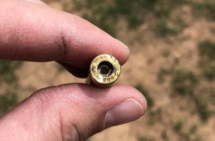

I had a primer blow out on this stuff last week. Jammed between the new case and the barrel extension lugs requiring tools to clear.
Haven’t contacted Hornady yet since I’ve been on vacation.
I cant tell if thats a Lake City headstamp or not but anything from the frontier line made lake city has been having pressure issues that are pretty common.
I’ve been hearing the same thing for awhile.
