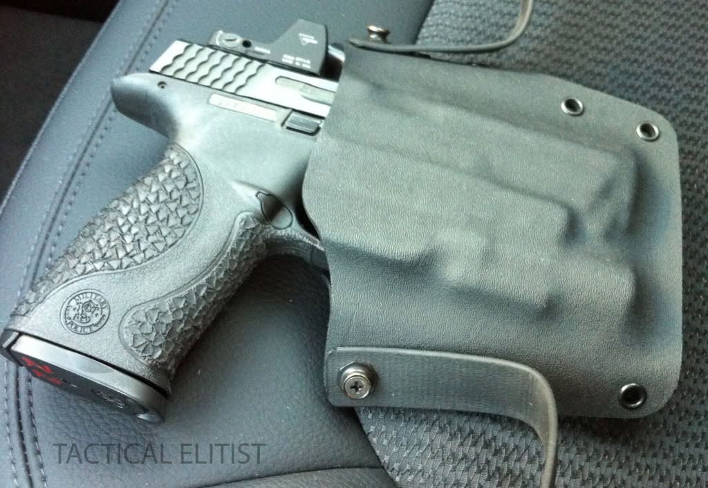

Secret city weaponeers custom
Blade-Tech custom

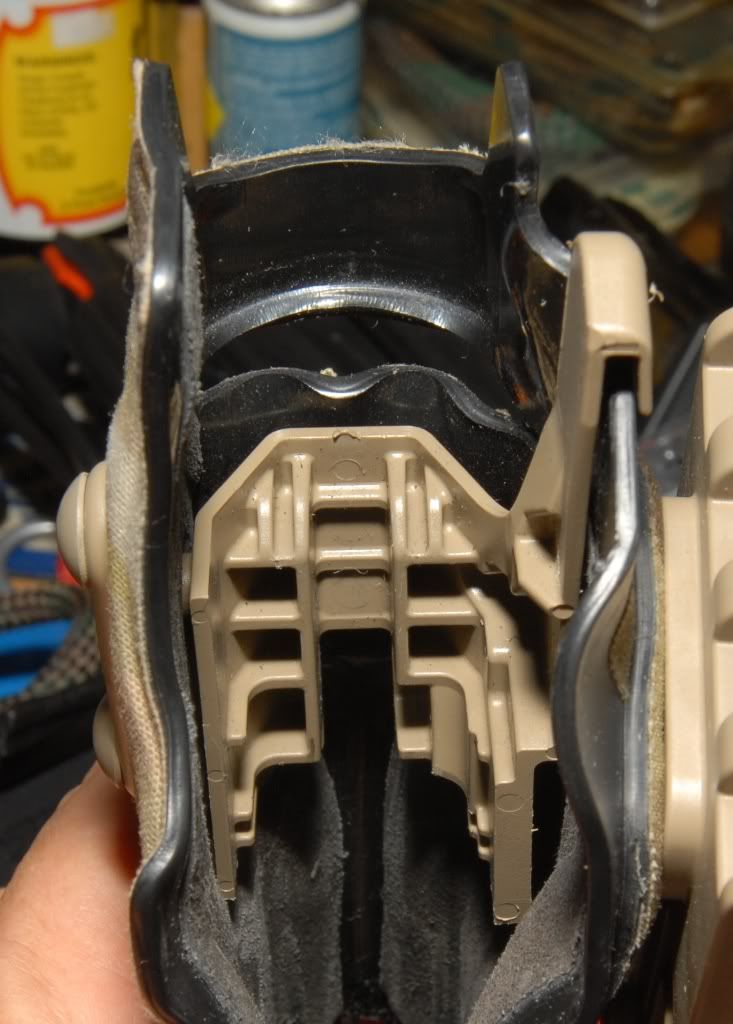

The new Safariland 6354 ALS for RDS equipped 9mm/.40 Glocks is the best duty holster currently available for these pistols.
The bad news is that my Glocks did not fit into these holsters since my RMR’s are mounted forward of the rear BIS.
The good news is that it is a simple 10 minute fix. The following suggestions are for a right hand holster. Remove the three black screws and take the QLS fork off the left side of the holster. Then remove the two tan screws holding the right side spring device for the ALS system. Slip the tan ALS thumb over the edge of the holster, then take a punch or small screwdriver and pop out the left side ALS hinge/axel point that extends through the body of the holster, then lift out the tan ALS device. As noted in the photo, remove 1-2mm of plastic at the leading edge of the ALS device.
Check to ensure the bottom of the ALS device appropriately locks into the ejection port.
In addition, 1mm or so of plastic needs to be removed from the holster body where the front edge of the RMR will hit.
A stock holster:
Modify as shown:
Pop the ALS device back in, seating the right hinge/axel first, followed by the left. Re-attach the other parts. Check to ensure proper ALS lock-up. Then enjoy!
