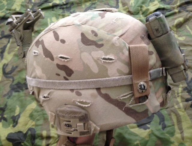

this is the older style mount:
as opposed to this newer one. It articulates more, but it sticks out significantly further
As to accidental activation, I have never had an issue with it in deployment or training environments. The switches are pretty well protected, and if you get in the habit of turning the battery lock-out feature when it’s not in use, you will probably not have issues. The very first generation of these lights had a wonky battery cap safety… any recent production one is much better.
