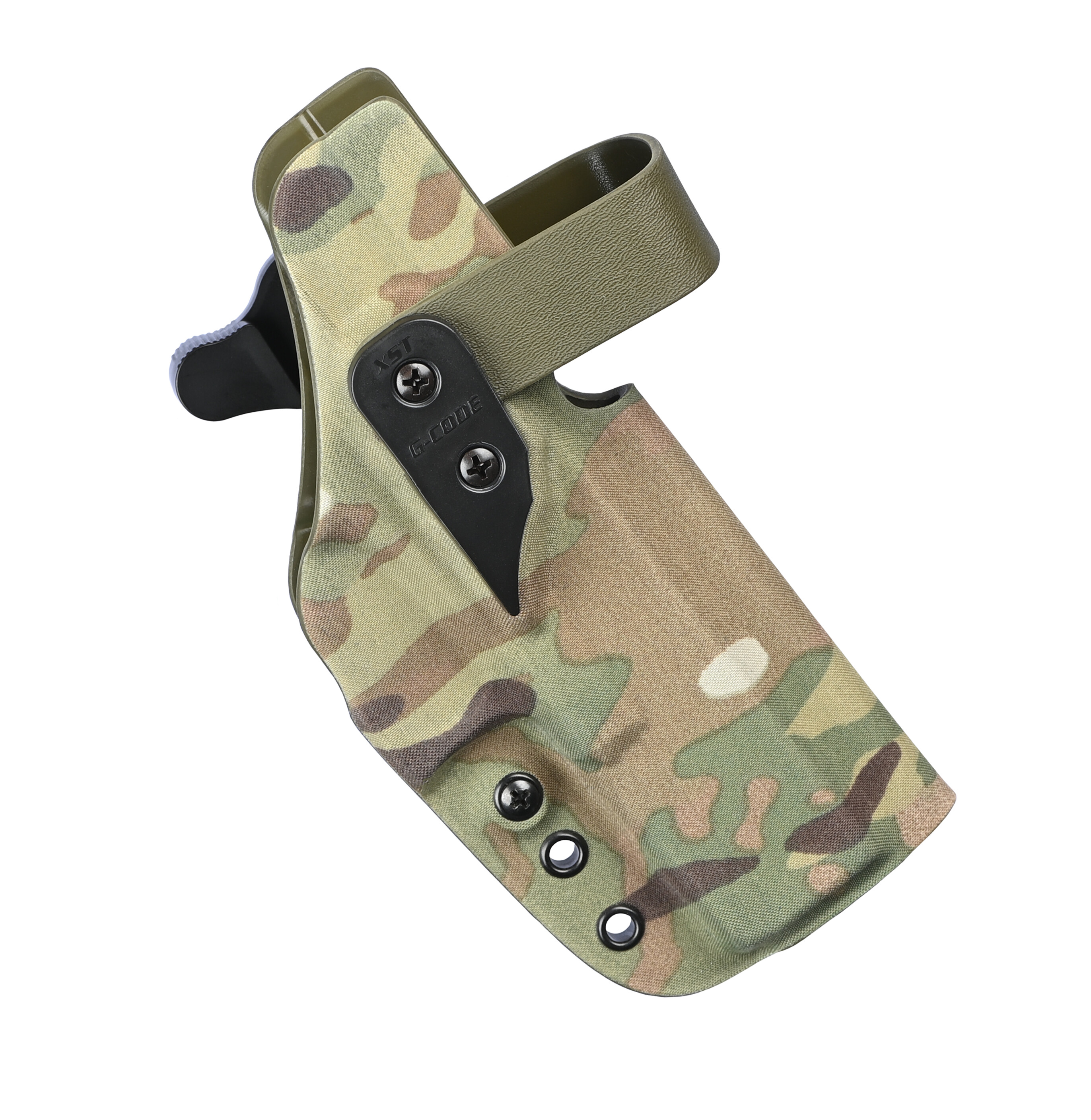

That being said, G Code has been making a Gen 5 G20 w/optic holster for awhile
and I picked up a friend’s when he decided to trade his G20 in.
Not sure why or how, but the release on the G Code optic models is almost identical in location to the ALS release versus a non optic model i tried a few years back which had the release set further away from the pistol. Wouldn’t be an issue if using only a single G Code holster, but going back and forth between an ALS and the non-RDS G Code would turn the draw stroke in to a stabbing around with the thumb PITA.
Overall it is ok other than it’s retention works like an open top kydex holster by snapping on to the light and is a bit too tight. Even with the retention adjustment screw backed all the way out, it takes a fair amount of pull. If it wasn’t a cordura wrapped holster i would be inclined to try some heating and reshaping.
The G Code RTI QD mounting works well, but is heavier than QLS/MLS and significantly more expensive. The G Code holster body is usually lower cost than Safariland, but the RTI quickly overcomes that.
