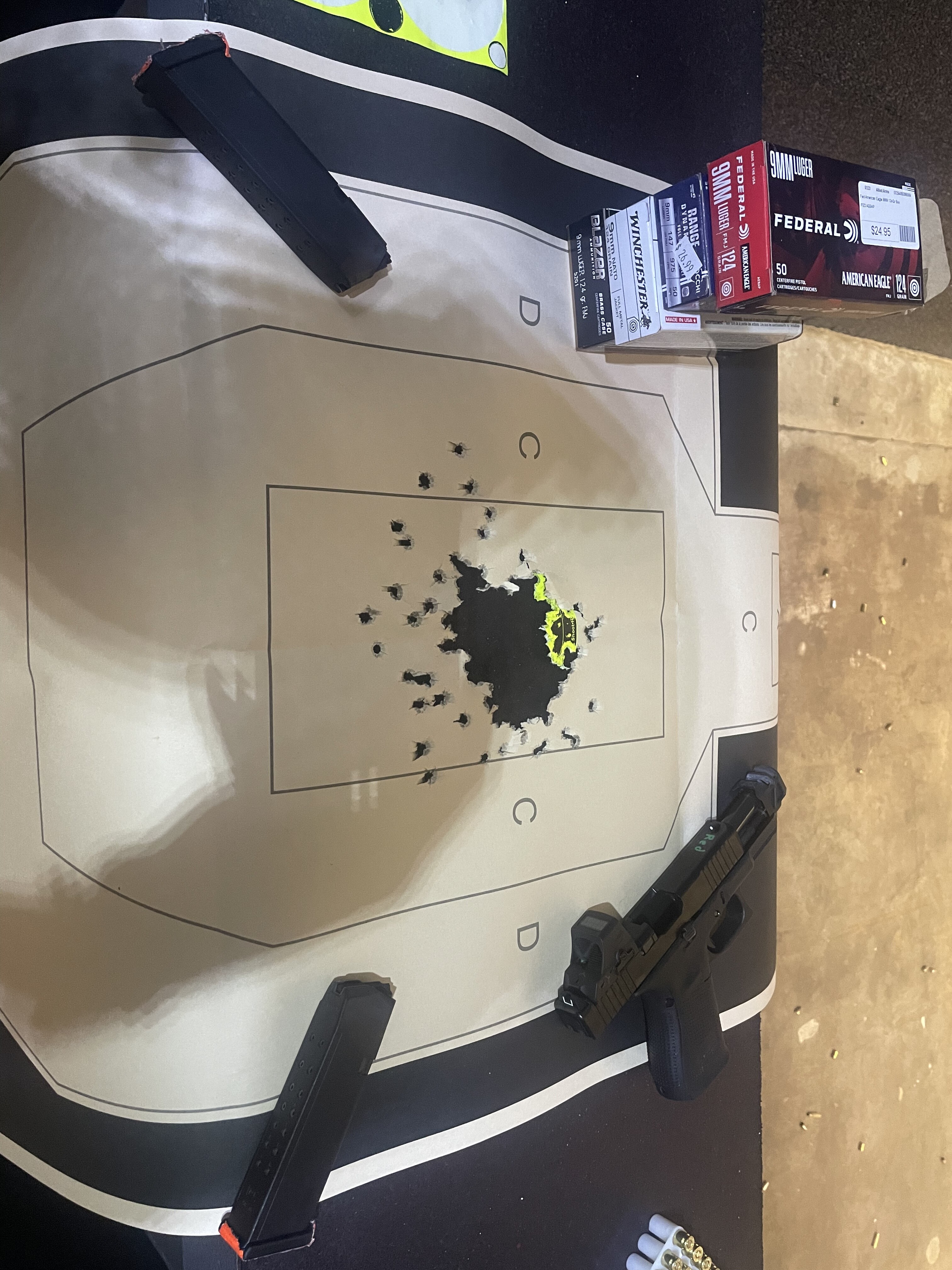

Today, I grabbed a couple mags of standard-pressure 124gr Gold Dots and XTPs, and a box or two each of Winchester 124gr NATO, Fiocchi 147 FMJ, Fed American Eagle 124 FMJ, Blazer Brass 124gr, plus mixed lot of 147gr coated handloads, and a random 115 (I think) Fmj round I found in my cupholder.
It ate all of it, flawlessly. Locked back on every mag, including the rando 115. I shot a course of fire based on the FBI qual, a bunch of times, as fast as I could. I also ran it once strong-hand only, and once weak-hand only. I hit the C zone 4 times, sadly. That’s on me.
