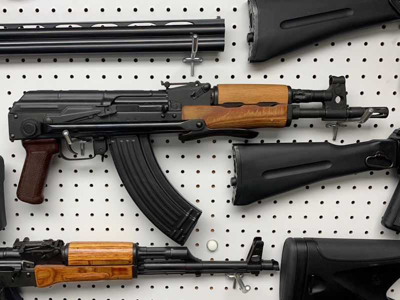

While I’m a complete AK whore, I just can’t bring myself to buy a mini Draco. I do really like my SBR’d underfolding Draco.
I’m with Bret, but I made mine a side folder.
If you can swap out the rear underfolder trunnion for a regular rear trunnion, I think that the side folder is more functional and looks better. Here’s my underfolder.
