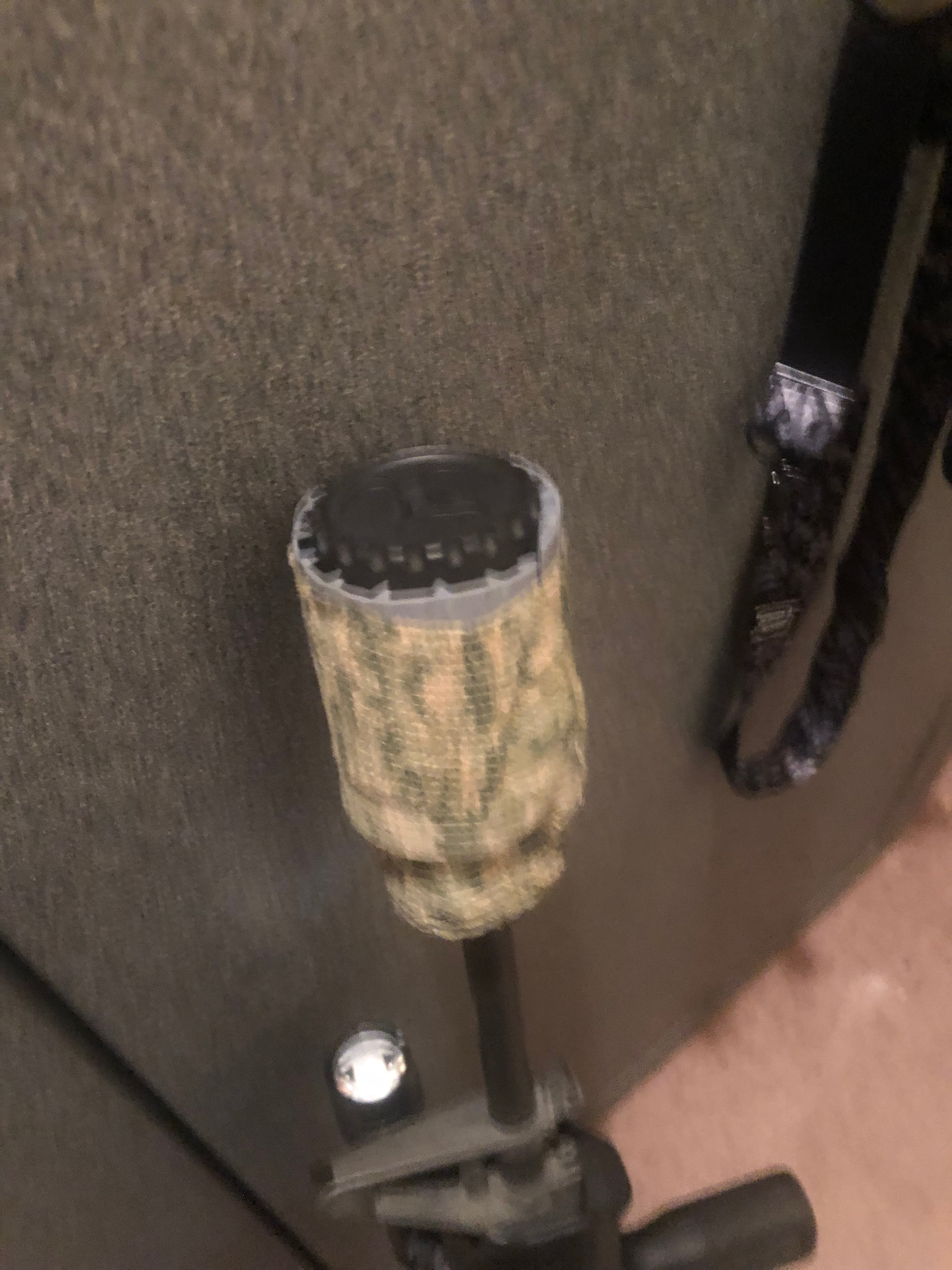

After melting a sling on a hot suppressor I needed to do something simple so after a little research I made a homemade cover from a silicone heat resistant mat. It looks a little ghetto but works great- I have had it hot enough that the medical tape on the outside melted but the silicone mat was just fine. I just resecured it with more tape and continued on.
