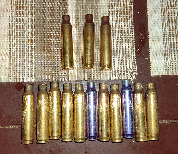

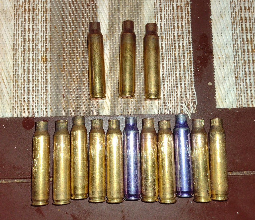

How did they screw up the XM16E1?
I’ve talked about it before but it has serious ejection problems, likely due to a rough chamber. Ejected brass is scratched all to hell. I’ve tried cleaning the chamber thoroughly, but it didn’t make a difference. Ironically, this was one of the issues the original XM16E1s had.
Since I got the rifle for collections/reenactment purposes, I’m not too worried about it but it’s not exactly confidence inspiring, to say the least.
Pics of brass, lower row:
I’ve seen this before. If the barrel’s are nitrided and the brass is scratched like that, the fix is to get honing oil, honing brush in 223, and a hand drill.
