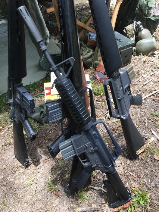

A few weeks ago I received the grenade ring I ordered, today I took a few pics of the rifle
