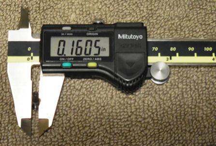

Lots of anecdotal failure stories. An #8-32 set screw in an #8-32 set screw. Not sure how one variant of GB can have more precision threads than the other. If your going argue that they can, please document that there is a difference between the two GB’s.
Considering they’re 10-32 actually there is a lot of difference. The SLR uses slightly oversized threads in the block so that vented gas and fouling is released and doesn’t foul the threads to the point of seizing. Syrac is standard thread mating and makes no such allowance.
Really? The set screw in my Sentry 9 is clearly an #8-32.
How oversized? Half a ten, three thousandths? Interesting claim considering this statement from SLR’s website… “100% Gas seal allows full cut off and prevents gas from fouling metering screw”

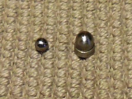

If the Syrac model does have a higher rate of seizure compared to the SLR, it’s likely due to the difference in the detent mechanism. The Syrac model indexes every 90 degrees compared to the SLR at 120. To accomplish this, the Syrac has to use a very small bearing compared to a larger custom detent in the SLR.

Syrac’s adjustment mechanism is a COTS mechanism in that the bearing and spring are installed in that hole to do the job. They’re not purpose designed for the job. Do they work? Yes. Is it subject to failure? Yes, as we’ve seen. The screw that Syrac is using looks like an altered COTS part as well. I’m not saying it doesn’t work but it’s certainly not optimal as we’ve seen many that seize under moderate round count use.
