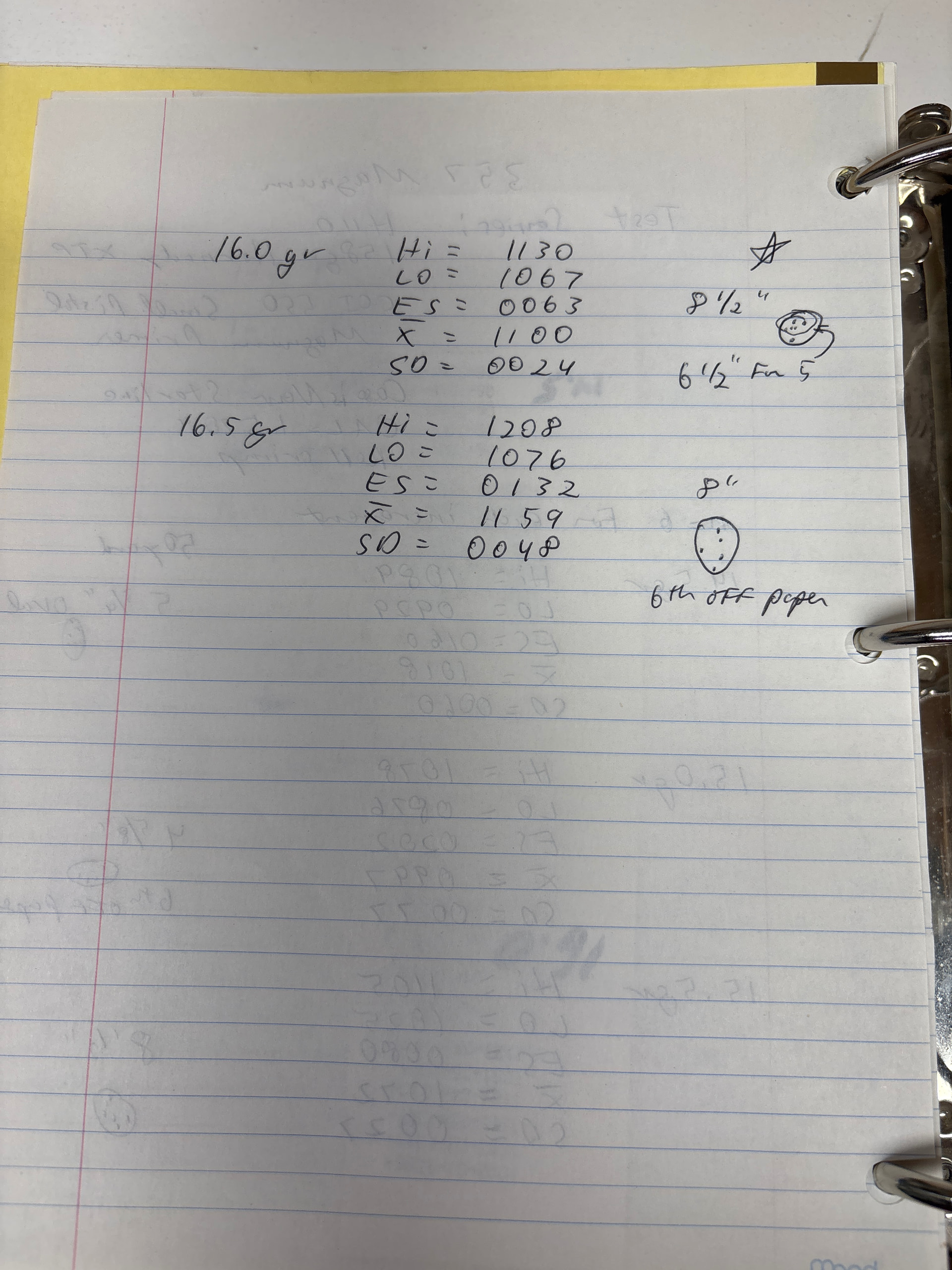

John linebaugh influenced my thoughts on revolver loads. With my 357 magnum and 41 magnum, I stopped at 1200 ft./s. He was under the opinion that anything more than 1200 ft./s is unnecessary with excessive recoil and muzzle. blast. After several years of shooting, these revolvers with my own hand loads achieving 1200 ft./s, I agree with better follow up shots.
For the 357 magnum, I use Hornady 158 grain XTP, H110 powder with a small pistol magnum primer. This is from a Smith & Wesson K frame 4 inch barrel 357 magnum.
Have you chronographed that load?

FWIW I’m going to use a Lee Breech Lock Handloader and do maybe 50 rounds for testing, settle on my pick and crank out 1000, 500 for weekly range practice for the next month or so.
So much for my fabulous memory.
I found 1100 fps to be the best by group size at 50 yards. Measured with oheler 35p
Yup. You need that 16 gr load at least to keep the Low rounds right at the threshold of expansion at whatever range your chronograph was.
